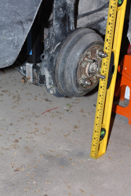

The Rear Suspension:
Full droop:
Full Bump:
Spring clearance at full droop:
Spring clearance at full bump:
UCA Clearance at full bump:
Numbers/Analysis:
18.4 cm of wheel travel, 14.2 cm of travel at the shock. Limit in bump was the tire hitting the wheelwell. Limit in droop was twisting the RTA bushing - I’m using a jack to press up on the forward point of the trailing arm, and at this point the body starts lifting. It can be re-clocked to give us more droop - assuming that gives us more travel, our limits move to the front end of the trailing arm hitting the chassis, and the compensator arm hitting the ‘frame rail’.
Fully compressed OAL, measured from top of the stock tower, to the bottom of the “shock” (not including the “fork” on the bottom) is ~31cm. It’s the back, so shock towers could be easily extended if needed.
I didn’t do any measurements of the actual shock on the rear to see what the off-the-shelf travel comes out to - but I’ve got a ‘feeling’ that it’s not as much as one might like - even with the spacers removed from inside the shock that should give an additional 15mm of extension at the shock.
