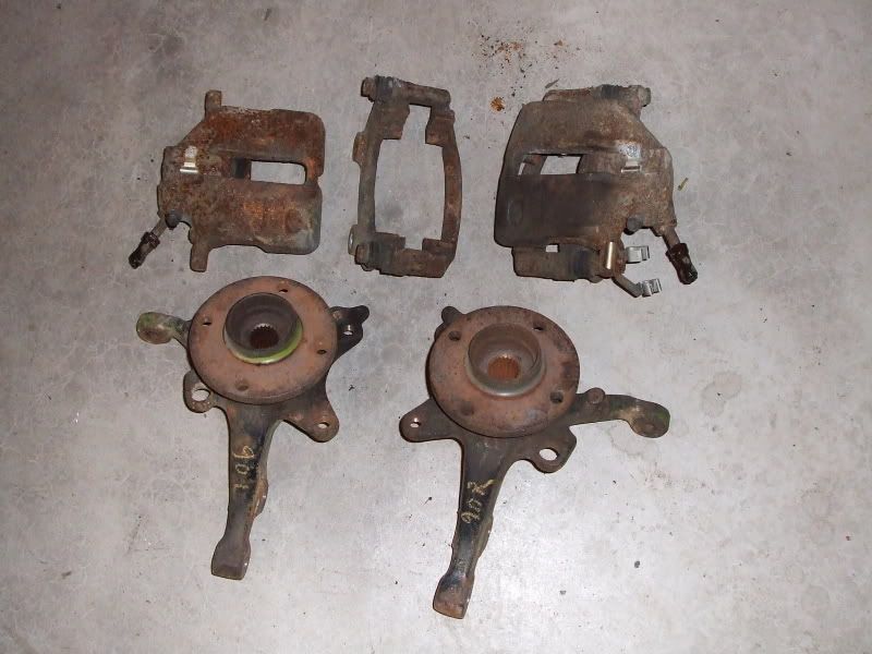

But Robert brought up sumpin I have often thought about and seen on my beloved Saabs on the other end: reinforcing the front knuckle. So I drug out my trusty VW Golf knuckle I have for a welding fixture and that looks like this:
Now reinforcing is easy enough since we have our good man William Steel Solutions wielding his trusty light sabre, but I was pointing out the elk antler (oder auf Deutsch "Elch Gewei"winking smiley thangs the calipers are forced to sit on.
Now Robert says all the Golves he's seen have the grosse faule "Elch Gewi" mounting for the calipers and I says "Oh yaH! Then what the fuck to I remember the figure 89mm between centers for the ears for, huh, huh!????"
So the question is Boys, are all youse guys using knuckles with these hideous growths sticking out in the way????
Because what the hell you do when you want nicer calipers than those flexy boing-y thangs that are stock???
Further question is should we, the little collective pool of talent here, make some modded knuckles for you poor saps?
Modded to allow nicer calipers and stronger?

Yeah I mentioned that as a clear brearing and hub and potential brake upgrade.
But the first question remains : Are all Gloves saddled with this knuckle?
The Corrado thing is nice but are they common enough in the Spare Parts in Wating Depots commonly called "wrecking yards"?.

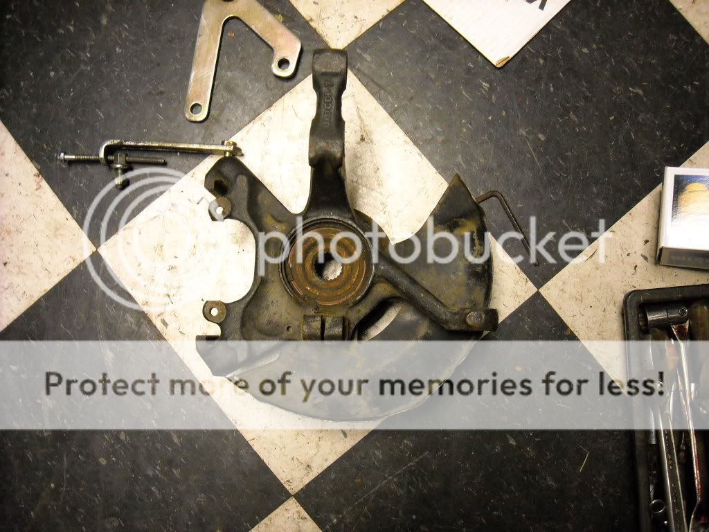

Heres the best pic I have of the corrado g60/jetta 16v/some passats/mk3 4 cyl knuckle.
They came on lots of stuff and are easy to find. They fit 10.1-11.3" rotors for stock setups. The knuckle you have does the 9.4" rotors.

So are ya saying that we should try and find those cores to make mo better?
Are there any guys out there with the Elk Atler style?

April 08, 2009 11:04AM
Rallymech Wrote:
> Carl,
> The above mentioned brake conversion requiers 15"
> wheels yes?
> Robert.
As shown in the pic, 14" wheels will fit. It's only if you replace the 10.1" rotor with an 11" and the caliper with the 2 piston Audi 5000/G60 setup that you need to go with 15" wheels.
