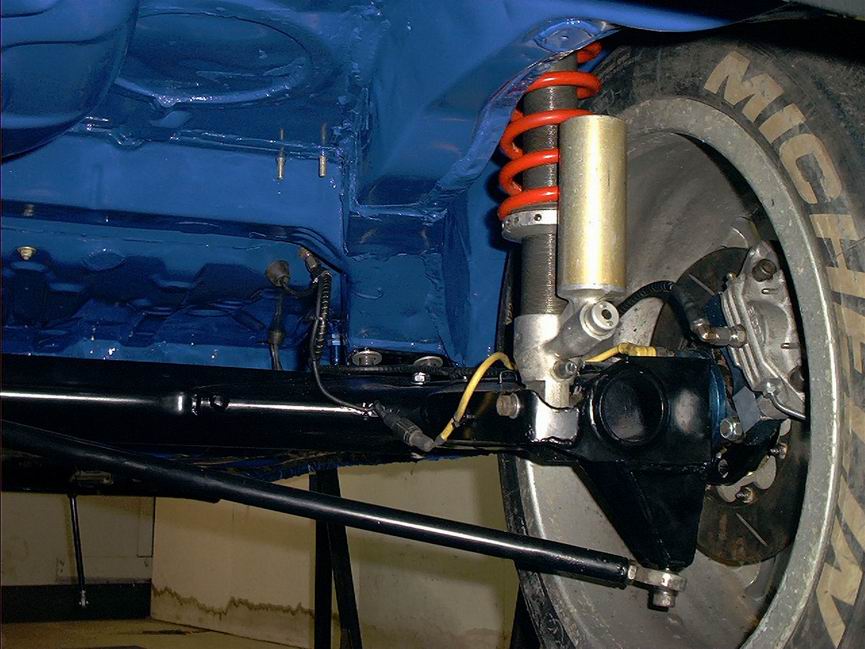

My buddy finished this up today for me:
should be cool.

Re: Hello There.
March 18, 2006 05:43PM
Does this help?
Lots more Golf build photos in that directory.

thanks skye. I guess I had to see it installed.
