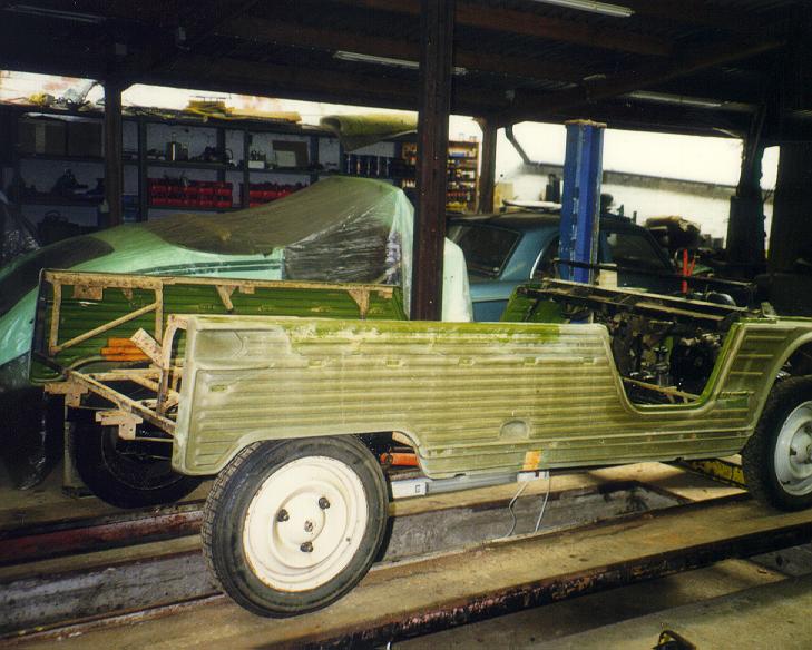

randyzimmer
randy zimmer
Location: Buffalo, NY
Join Date: 03/12/2006
Posts: 196
rallycross 13B Miata
Re: Cars that came with heavy ribbed/structural floor pans
September 03, 2009 03:19PM
lots of ribs, but they're plastic.
http://philison.users4.50megs.com/images/Mehari/inside5.jpg
September 03, 2009 05:28PM
Nice Citroen... Ideally I'll figure out something that has ribs roughly the right length so that I don't have to cap them all.. got lots of time to figure it out thankfully. I wonder if the old 2CV pickups could have something that's perfect
