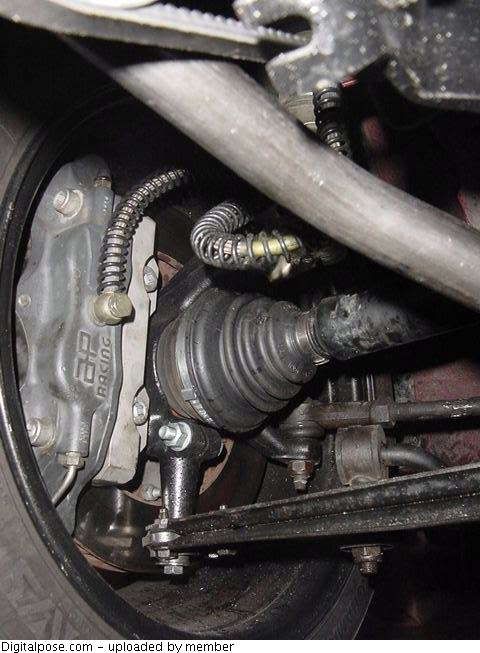

And then there's the RevoKnuckle.
They call out "Kingpin offset" instead of hub level offset, but it's almost the same thing. HLO is the horizontal distance along the axle centerline from the "wheel centre line" to the "kingpin axis." You can see how the HLO is much shorter on the Revoknuckle thanks to the steering axis being placed totally inside the wheel.
Now imagine what happens when you put coilovers on your car that hang down past the top of the tire. And then you put wider wheels and tires on for a tarmac rally, but you don't really have space (due to your fancy springs) to keep the same wheel offset and let the tires creep in on the inside as much as the creep out on the outside. So you grab those wheel spacers and space them out.
Now sketch that in...what just happened to your scrub radius? Your HLO?
There's a MS3 in Germany with one.
This is what Ford uses on the Focus RS.

I'm still wrapping head around hub level offset.
Here's another good one.
What' changing the kingpin axis do for a car?
Re: heres some fucking opposite lock for your high yellow ass
October 01, 2009 07:19PM
Oh wow, suddenly the influx of weird double ball joint suspensions makes a whole lot of sense. It allows them to have a simple knuckle while being able to put the steering axis wherever they want it to be.
October 01, 2009 07:34PM
wow that looks disturbingly the mistubishi awd stuff...
October 01, 2009 08:12PM
> it to be.
bingo
