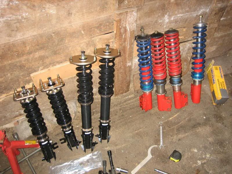

So the gpA stuff looks like this... I'm seriously impressed by it.
John,
Do you have steel peices to weld to the top of the strut towers? Or whats the deal on the conversion process to go to gpA on cars that don't have that style strut tower?
The other route you stated was Subaru.
The subaru tops you like to use look like this, correct??
Front
Rear
My last question is:
Do you use Fronts on all 4 corners or do you use front/rear like subaru does?

Oh, this setup from Norway? (the one on the right)
Well, the seller bought it in the first place from ATM sport UK, so I was sketchy on it from the get go. Then you told me, based on the damper part numbers that it was originaly a tarmac setup with 500/200 damping rate and 155mm of travel from a ford. But it's used and could be anything by now.
For my Mazdog that didn't seem like a good idea to pay all kinds of money for and to ship a BIG & Heavy unknown from Norway when I could put it towards brand new shit from you.
Plus IIRC, I can use 175mm travel in the gtx without issues.
So I'm going to have to finally give in and call you to discuss Specs and Terms.
I emailed Tim Taylor last week to get the specs on the setup you made for him and he said he'd look through his notes and get back to me.
