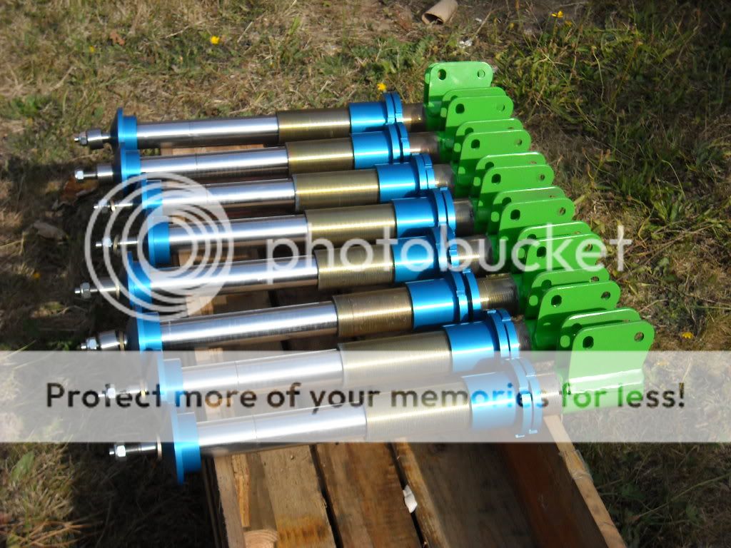

Well i packed some stuff that finally, after every single thing went screwy on. is all together and ready to ship---of course on a Holiday weekend costing more time.
Ozgur, and Lee, lookie:
190mm travel front, and 210mm back
We need to get the front preload right, may have to use those little flat helper springs, but lets see.
These should have wheel/tire clearance even for a little wider wheels in case you guys go do some tarmac stuff.

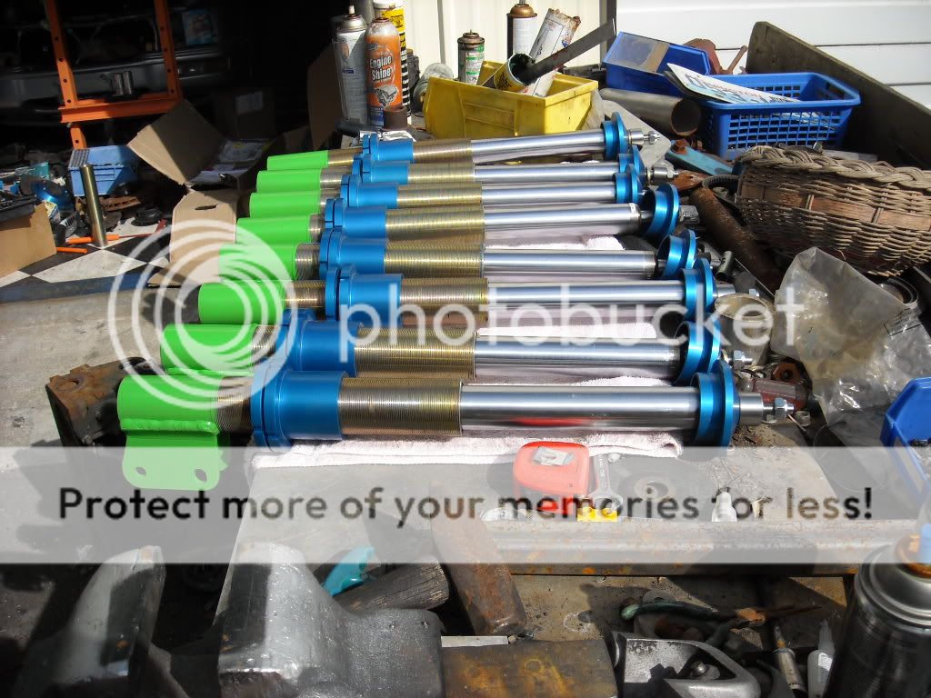

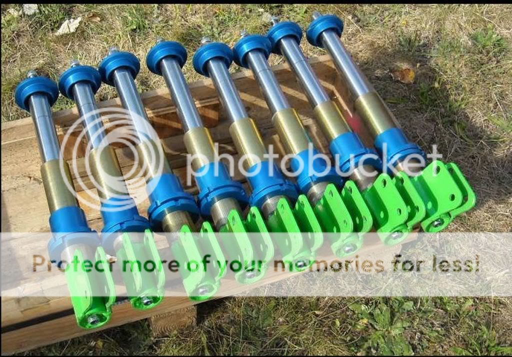

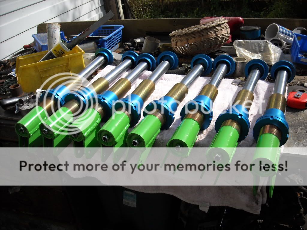

Hi ________________, well i could PM you but: why PM when the things you are asking are pertinent to everybody?
After 7 years, the price increases that have been nibbling at me finally resulted in a little increase, so these, being 4 strut cars (rather than strut front, shock back like VW, or Xratty of Corolla) are right at $2000/set complete with springs.
They are 4130 CrMo DOM tube, 6061 "aircraft quality" alloy bits, Bilstein 40mm diameter inserts---every one done up after conversations with end user---every one custom, so we have a choice of travel and damper settings and then of course springs to match.
These were set up to run original rubber/ballbearing top mounts, but I can do the strut tops to be say 20 or even 7/8" pin diameter if it's know the pin will be mounted in a spherical bearing and that's like multiples stronger.
The inserts can be rebuilt at Bilstein San Diego for $65 each, all parts can be replaced no problem, of course. It might maybe take some time justy depending on a) my inventory (I make these things and there is at times LOADSA money sitting in process or on the shelf, but still I can only make so many parts at one time---and then demand can spike and Whooops!) b) machine availability to make more (sometimes there are other jobs that have priority for machine time).
