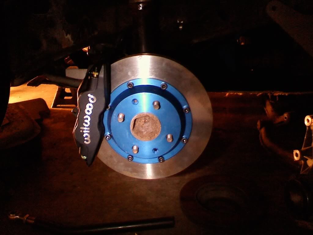

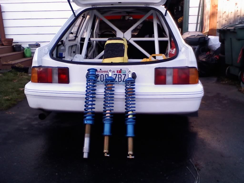

Just a teaser, here are a few of John's Merkur parts
The Front Brakes:
The Suspenders:

I think you get the idea....
