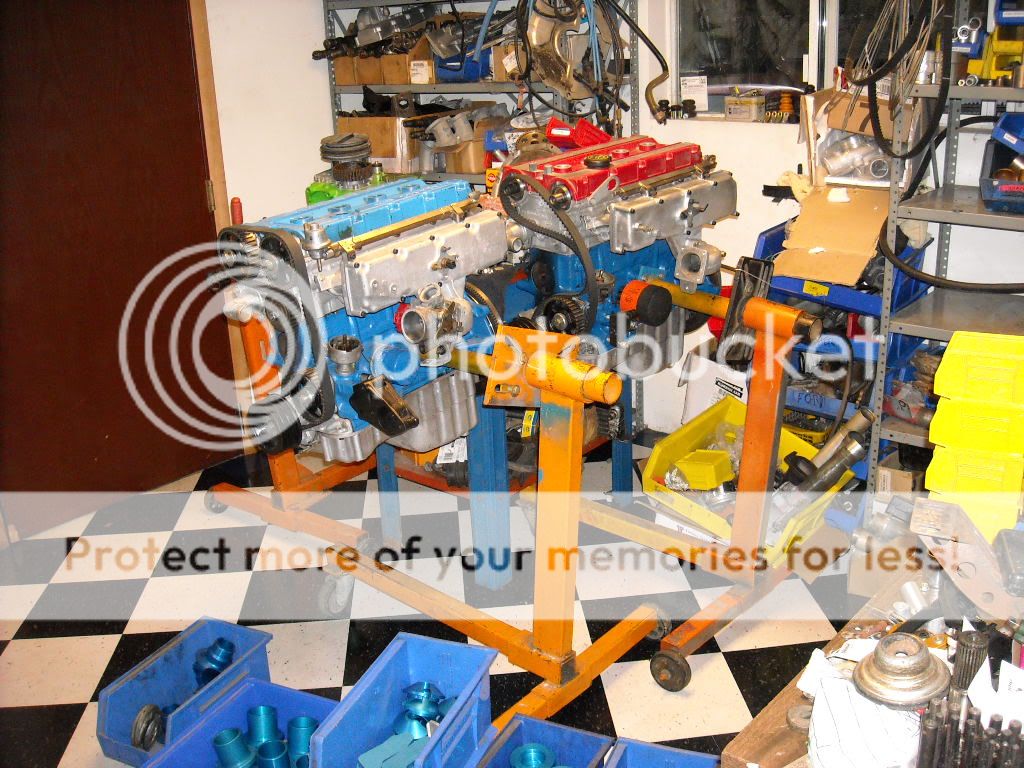

Look at those goodies in JVL's basement... if i were closer and had a bit of cash...

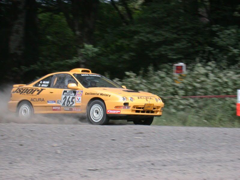

Does anyone know about this car? It is a yellow Integra. It last competed in the 2003 Mt. Hood rally.
I have serious doubts about the cage. The seller says that it is a homologated Sparco cage. It's made out of cromoly. The pictures indicate that it is mig welded.

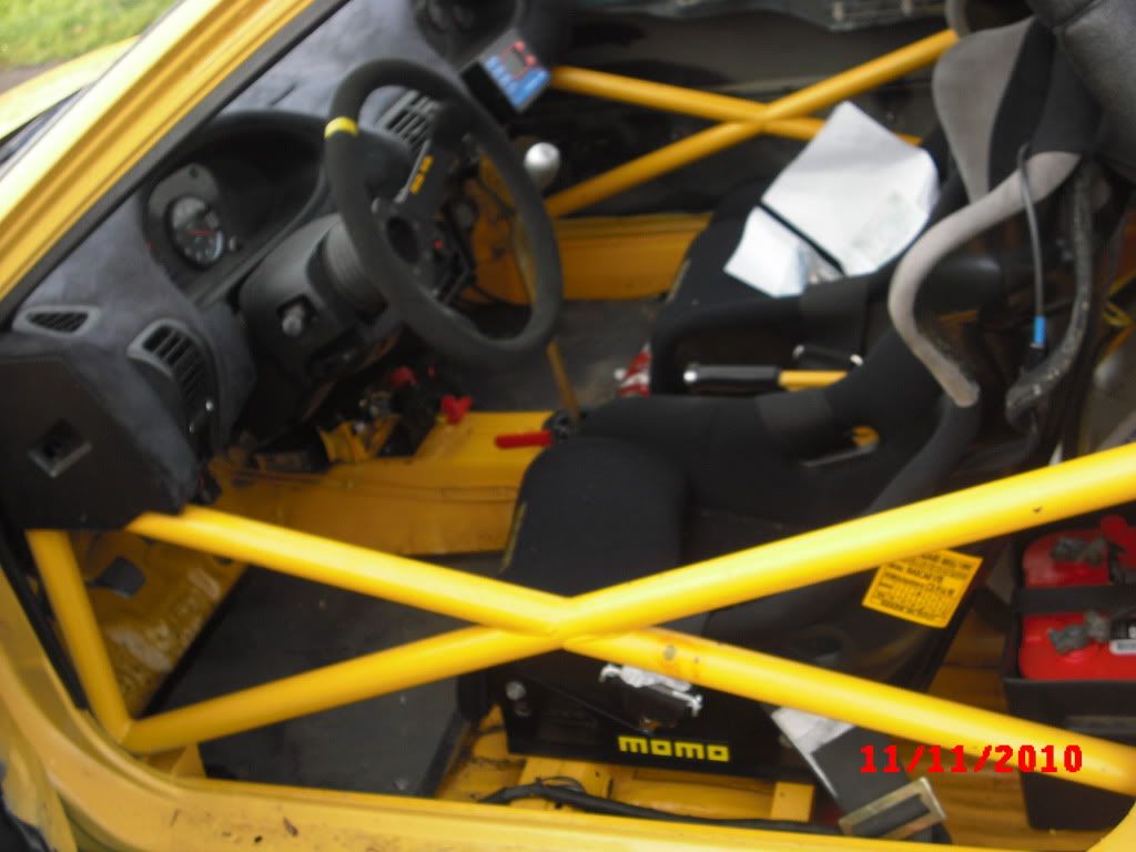

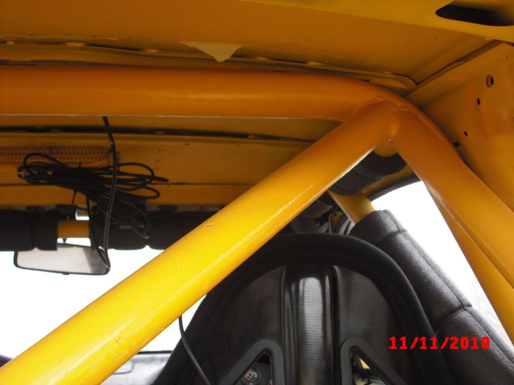

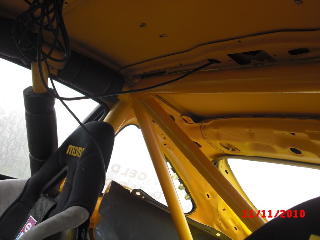

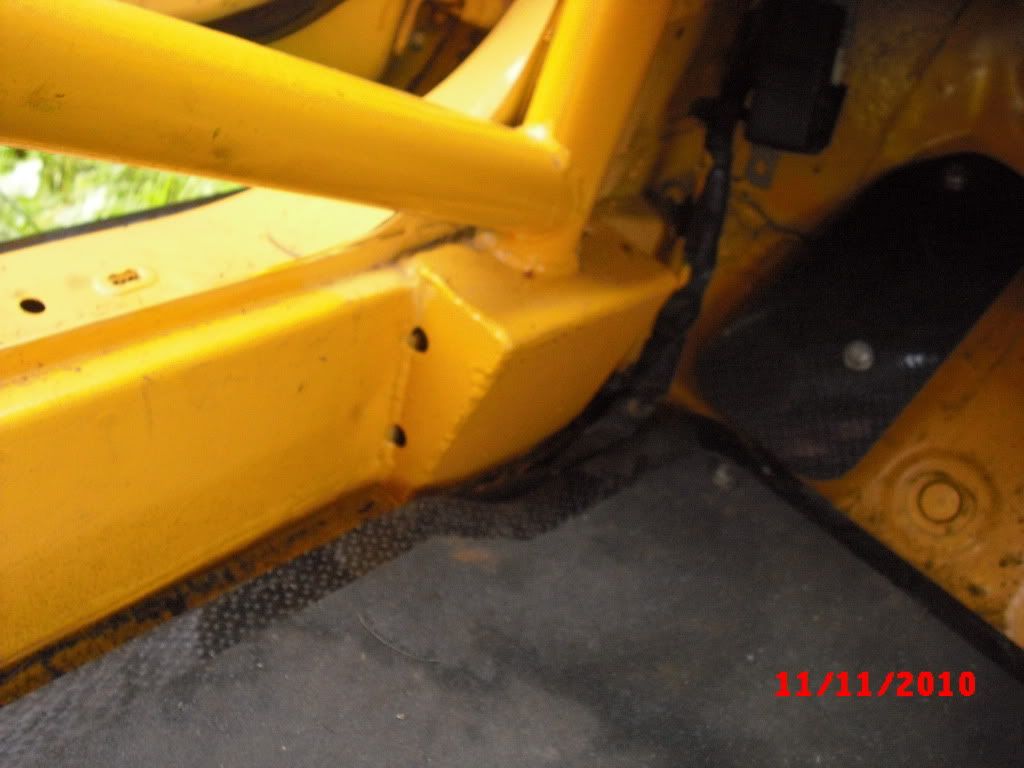

Here is the car and some cage pics.
Re: SCCA logbook to CARS
November 21, 2010 11:37AM
Couple of quick points on this.
1) The car will retain its SCCA logbook but if run by an entrant on a CARS License - and Canadians MUST run on a CARS license in Canada - the car must meet CARS rules.
2) The CARS rulebook is available online - download it and get familiar with it.
3) In the appendix at the back of the rule book (pg. Appendix 1) are the cage rules for cars completed between Jan 1, 2000 and Dec. 31 2008. Homologated cages are acceptable provided they are installed correctly AND have a valid homologation certificate.
The essence of the grandfather clause is that cars need to meet the spec for when construction is completed. So, if you buy a car that had its first log-book issued in 1995 you it would have to meet the specs for pre 2000 cages (page Appendix 6.) Those rules mirror the SCCA rules fairly closely. After 2000 there were some differences which makes SCCA cages really iffy. I know two cars (including a 'free' golf from Seattle) that needed to be re-caged to meet CARS spec.
The trick with a Homologated cage is that it must be installed as required and can't be modified. I know of a car in BC where they added elements to the cage which voided the homologation. I think they were told to by someone at a track they were running at... expensive mistake.
