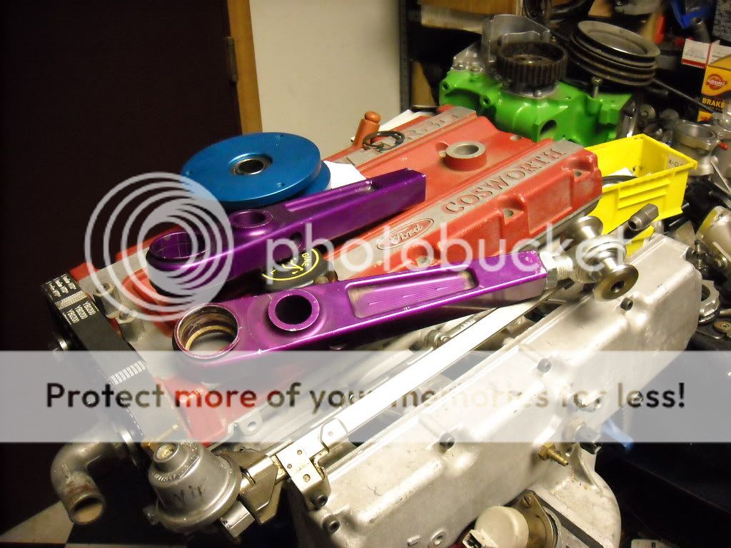

So here's the nice alloy Ford motorsport arms i have been trying to get a pair I can afford for for ever.
Thse are what i want to make as a "basic" arm to be tailored to fit a bunch of different cars---so the unit cost can be held lower by making a bigger series
This is an early version without the big M24 left hand threaded sleeve, the one's I'll be making pretty soon--ish will have the LH /rH threaded thing so adjustment of camber---and the compression strut will have the same, so camber and castor can be set by cracking loose a couple of jamb-nuts and twisting an adjuster, then snugging the jamb-nuts...
Who is interested in really strong, really nice adjustable arms?

Yes! Those are awesome! Plus my ball joints are f'd and happen to be integral to the arm! Now, what color is KB's helmet?

Martin---and all youse other wise guys, measure the width of the inner pivot bush.
Seems there's a limited number of widths and we want to collect them so I can compare the trumpet shaped stainless inserts we already have for Subies and 4 links.
The compression or tension strut bracket thang is sumpion that will have to be tailored to each application as well as whatever we have to do for the ball joint pin..
But I'm jazzed. I have been spoiled by have an old nice double a arm Saab with easy camber and castor adjustment and have always thought it'd be nice if ordinary schmucks like "us" could have cars where we could set the suspension parameters, and of course have strong enough stuff we can whack into things and KEEP GOING at speed.....

So, what you're saying is you need the following info for all the different cars:
Length of track control arm
Angle of ball joint to TCA
Length of compression struts
Mounting direction of compression strut (to front of wheel well or to rear)
Mounting distance of comp strut to TCA from balljoint
Ball joint mounting to spindle info. Type, angle, etc
Re: Adjustable camber/castor on club level cars, who is interested?
December 07, 2010 05:05PM
Length of track control arm from pivot to center of balljoint
Angle of ball joint to TCA more or less
Length of compression struts ----nah not now
Mounting direction of compression strut (to front of wheel well or to rear) sure
No1: width between the ears on where ever the arm plugs into subframe
ie width of the sleeve in the rubber bush the arm pivots around
