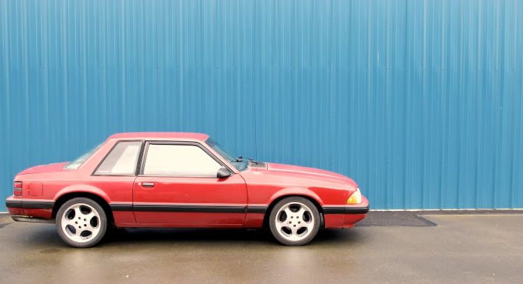

Did someone say foxbody? Just got done daily driving this one for the last 4 months. It was a hoot, a'real steer with your foot kinda car. I'm going to miss it. Every time something broke on it, I would just drive upto Napa and they would have it in stock. It was great.
I'm going to get a hatch(w/capri trunk) next time.
