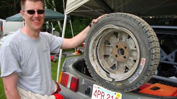

Ted and Keith - not rough? - did you drive the southern and eastern loops of the Middle Dam stages? Most of the stages were nice, but there were sections that were old school - POR type rough. You could avoid most of the rocks, but it seemed like a rallycross with all the dodging around orange objects in the road I was doing at times. eye rolling smiley
NEFR was a shakedown for us - went into it with that attitude, finished the event, and came out with some lessons learned about the new car.
1. Stock 1980's XR4 Spatula rims are mega strong on the outer rim, mega weak on the inner. Broke (as in split apart) two rims causing flats and bent at least 3 others to the point that they still held air, but are no longer usable. All the damage was on the inner side of the rims.
2. JVAB suspension rocks. smiling smiley The suspension handled some pretty rough sections without a single complaint.
3. Need a co-driver's foot rest. Said rough sections caused co-driver to yelp a few times because he couldn't really brace himself much and took it all in the butt.
4. BFGs are worth the money. Not a single failure due to the tires. The tires that went flat due to rim failures are still good and will be reused as spares.
5. Need more power...
6. Need a limited slip...
7. Need real rally wheels...
8. Need more money (see points 5, 6 & 7). tongue sticking out smiley
9. Freakin' love this car! Handles fantastic, does exactly what you tell it to do, very stable, and a riot to drive.

I have a set of Saab 9000 wheels that I can part with if you want to try them out. Can deliver to Rally WV.
Matt, you've done some events with the Saab wheels, any reports, assessment, opinion, E-pinion of these 9000 wheels?
I mean if'n Tim just smashed up some Xratty wheels maybe he's all worried the Saab wheels might also be cheese-oid, ya know.
You going to West Virginia?
Any of you xratty folk use the 4x108's off an old audi? They hold up ok? I've seen the photos of what vittorio does to the cars and I'm assuming they will be alright.
Re: NEFR 2011
July 20, 2011 10:10AM
They have a smaller center bore so you have to bore them out to use them. I had some Compo TH2 17X7.5s that we used on the Audi that we drilled and were going to use on the Merkur but the wheel width combined with offset combined with coilovers meant a 1" spacer and they just looked retarded.
JEEEEZUZ!!! OK weeze gotta find sumpin. Talk to Mothra, he's good peeple.
Yeah for you, but I gotta figure out what Mark Piatowski is doing to murder his rear struts.
Yeah, I built one out of t semi-truck step (ya know to climb up into the cab).
Nice perforated aluminum designed for grip.
My old Saab doesn't have a tunnel and I have had the old Original Dave Clark's size 14 Doc marten's boots mashing the gas down from terror before--which didn't help.
Get a foot rest, mount Odo remote zero and a intermittant wash/squirt so when you spoooolshie thru some fawkin lake and can seat a thing , you far ahead looking Kau-draiver who noticed the huge puddle will have already mashed the wipers on---they're so thoughtful.
I love 'em. I lurv buying the one event old then stomping on guys with new ones.
