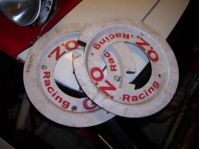

I've got a pair of extractors. I think I'm going to refurbish them, or try & get one signed.
Ascona73
Bob Legere
Location: Spofford, NH
Join Date: 03/07/2007
Posts: 310
1971 Opel Ascona
Re: Lesson for today
August 26, 2011 11:29AM
Sean Edwards
Got any pics of the backsides of those things? Just curious what they look like.

Yup.
I found these for sale today in Poland. For some reason I don't get return emails when I inquire from America.
17 x 8 tarmac wheels and the fronts are pre drilled for the discs.
