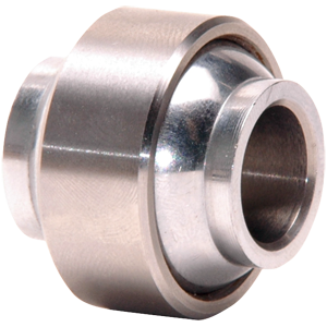

Ford used a 22mm high-misalignment bearing that looks like this>
Typically I see the generic Japoniasie (and other Asian stuff probably made in China) stuff around 15-16mm and I say its undersized

If you don't have these:
Get some.
Then you can measure the ID, OD and width.
