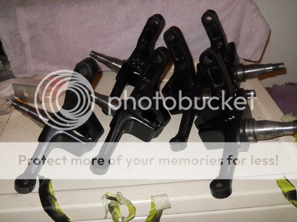

Hey John, am I correct in thinking your over visiting family on the red planet, um I mean china. Both Blake and myself have been trying to get in touch. I have a set of spindles to send up but I seem to recall you saying something about larger spindles on the newer 240. Am I smoking crack? Just wanted to confirm before I scrubbed these up and shipped them off.
Zap zap my ass...
Re: To all those with Suspension on order from JVAB
October 23, 2012 05:57PM
Yeah, measure the inner bearing, the big one, you want then and I hain't sure when perxactly the change occurred but around 79..
There's 1.25" ID and 1.375" ID I think.
We gonna do this we otter do the bigger..
Get 'em here cause I'm welding fast and furious, just welded up Tony W in Chi Chi Town, and Xrattista James Bass' stuff a few minutes ago so next up is BMW then Volvo and Toyotas---I knead knuckles....
John Reed said he's sending Toiletta stuffs.

If yours are the small spindle, and IF the hubs won't accept the bigger bearings, I am sure I have enough hubs at the low low cost of maybe 1 pack of American Spirit Blue each--which is a lot cheaper in 'Orey-goon than here.
Let me know.

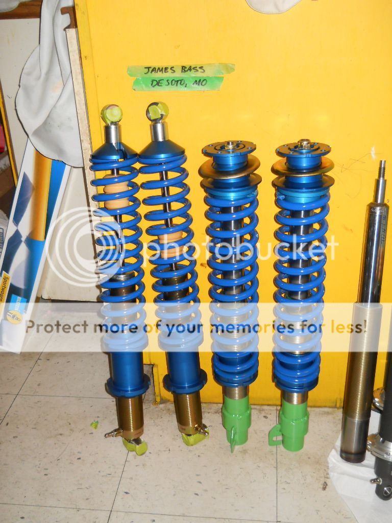

Your rally suspension is served:
And Tony W in Chicago here's some of your stuff for tarmac-- minus 1":
mmmmmm aluminum.....

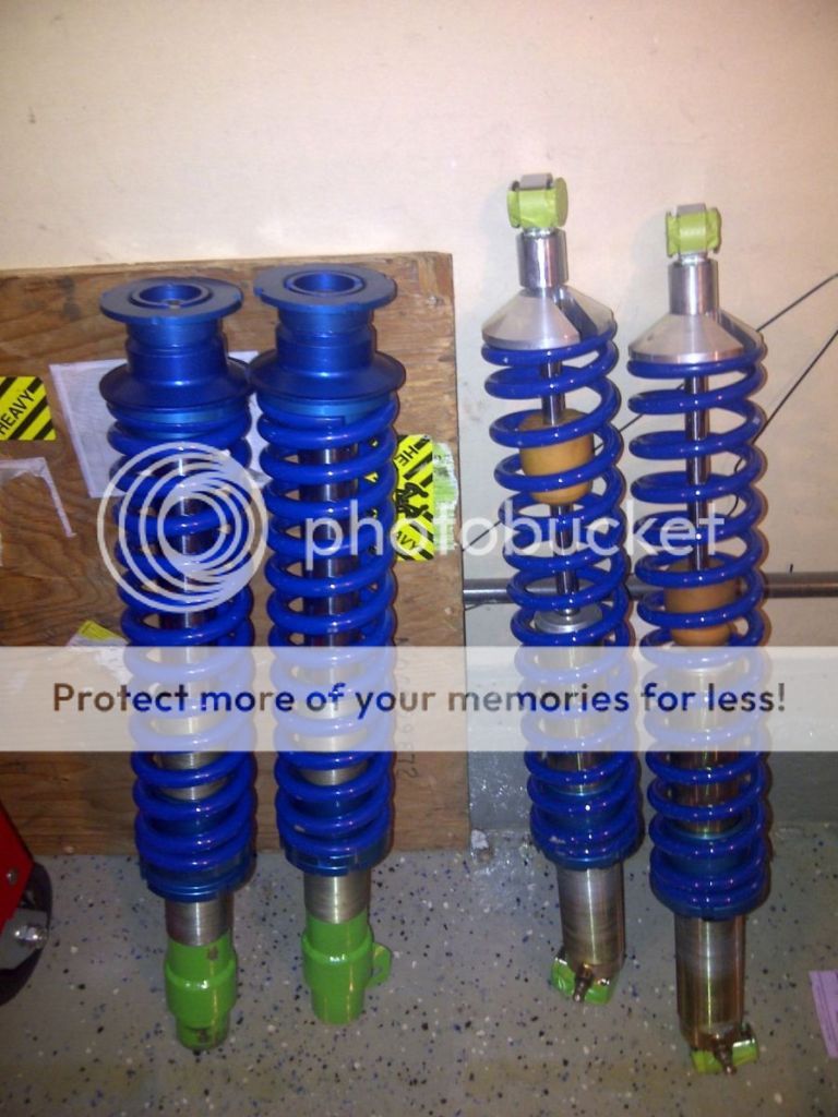

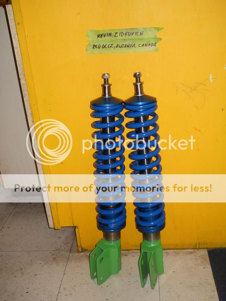

Kevin Zidkovich, Alberta, Patric Derow, Portlandia, Oregon, Arno Guerin, Sleezeattle, WA, Now you can change a strut in a few minutes:
Nice:
And Kevin, yours are ready to ship.
