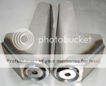

What I have in mind is basically a strut with at least 190mm travel, stock is 160mm but I'm thinking if we have to cut the inner fender well and zap in something like this:
Then we can simply choose to make it this high or that high...
And more travel in back isn't limited by CV joint angulation so in a way, why not do more travel?
