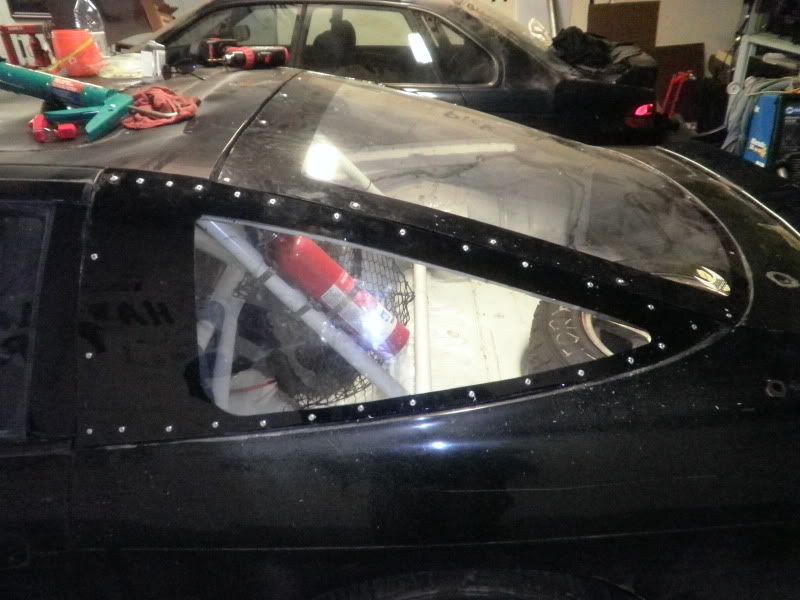

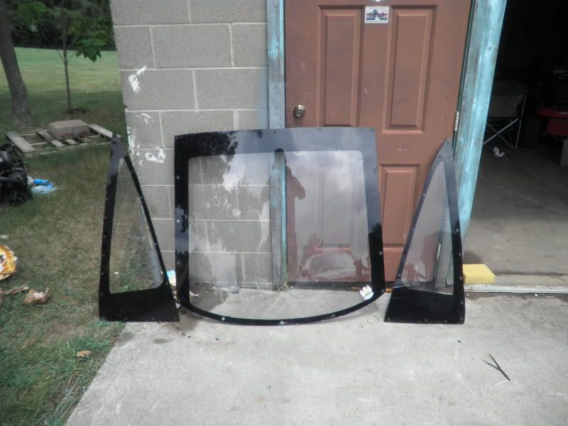

Here, here are some photos.
Off the car.

I prefer stainless steel button head screws. More work to install, less or similar to remove (compared to drilling rivets), allows you to tighten progressively and doesn't bend/break the lexan as the rivet tightens down..
If I ever need to pull my windows, this is the route I will go. Mostly for ease of removal in the future.
I wouldn't be worried about bending or breaking lexan. The stuff is dern near indestructible other then being easily scratched. There are pictures floating around of a someone who rolled their car and blew out the rear lexan windows. They were bolted in, and it snapped all the bolts when the body wrinkled. The windows were retrieved with no more damage then a little scratching.
PS, loctite is your friend if you go with bolts.
