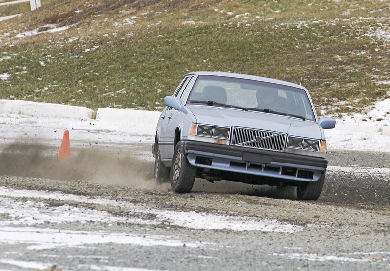

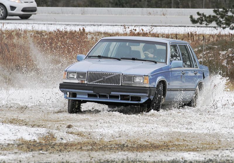

Also, just to keep the mood light, I figured I'd share some pics from the car's maiden voyage:

Thanks for the encouragement everyone! Joe (co-owner) and I are pretty stoked about building something that looks like the driver should be wearing a pin-stripped dress shirt with a while collar, suspenders, and trading stocks on a DynaTAC.
The car is damn ugly, and I sort of love that about it. After that one session, the local club has been using pics of it getting sideways for all of their rallycross advertisements. It definately gets some attention.

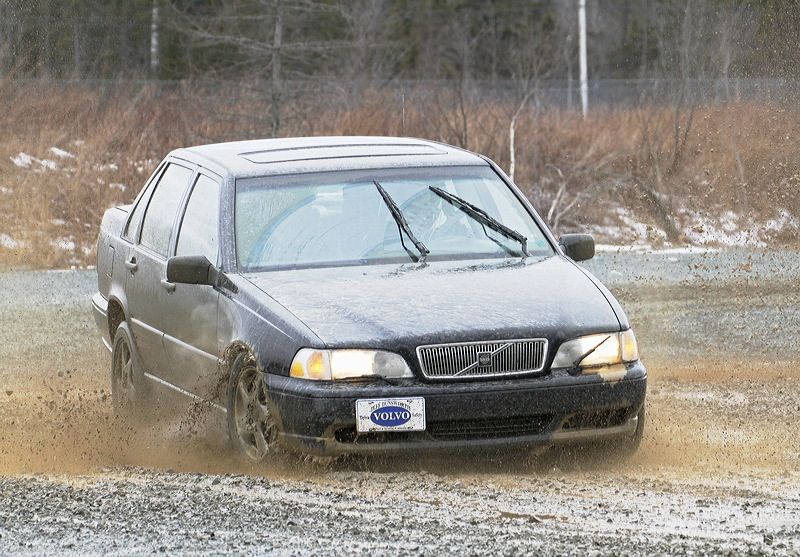

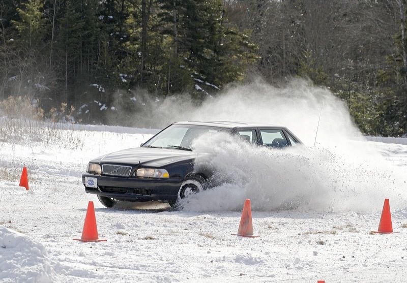

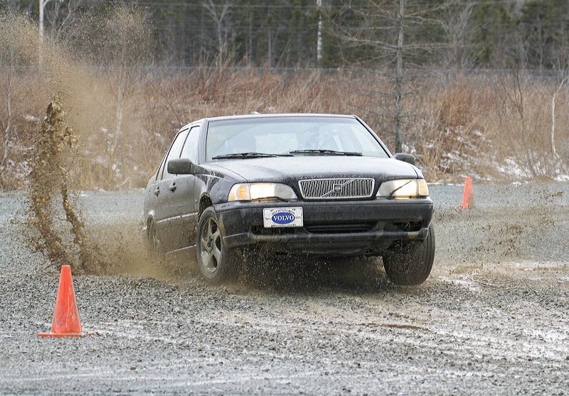

Just my experience with our 85 760 if you are going to swap the trans anyways I wouldn't bother with the m46 or 47. I have done one drift event and one rallycross with ours and broke the trans both times. But I am cursed with transmissions you might have better luck.
open | download - 313299_2193259025797_1086160141_n.jpg (73.6 KB)
open | download - VolvoRCedit.jpg (109.4 KB)
