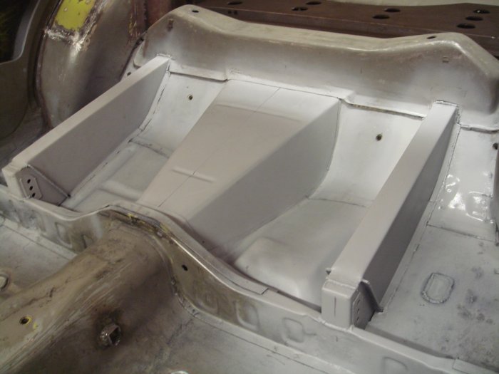

As for the rear shocks and the axle location, the 2 problem areas, easy cure for anybody who can weld:
Towers welded in something kinda like this:

see the turrets or towers in back.. That's the way to do it--except I prefer eyelet mounts on top

Why the eyelet mounts on top preference, John? Ease of maintenance (quick swap), availability, strength? Other?
Thanks!
Thanks!
When there's rubber in the suspension links, things move.
We hit shit sideways, right?
So that means things move <---that way or ----> not just ^ and V.
If you have PIN tops and they're bolted down snug when you whack sumpin and the link go----> the bottom isn't any longer under where it was and should be and there is a bend moment resolved right at the guide bush so there a high chance of the shock rod looking like < or > in steada I
When you have a spherical bearing top and bottom the sphere kinda rotates a little and the force is V and ^ and all is well.. Or weller-er.
So welding a couple of D shaped ears either side of a [ ] hole seems easy as does closing it off with a strip of scrap to keep the mud off and that is cheaper than buying my Sooooper Bitchin HD M12 Stainless Steel pin mounts when the shock come with nice spherical bearings..
Make sense?
I have a nice metaphor most guys understand involving thinking of lingham into yoni and all is good and its plongé plongé all is smooth TILL the angle of the dangle is too great and plooop! Not good.
Its similar.
Edited 1 time(s). Last edit at 12/24/2012 06:16PM by john vanlandingham.

I see - so you are advocating not just an "eye to eye" shock - but one with spherical bearings. Here all this time I had rubber-bushed ones in my mind. I get what you're saying about bending the shaft-end as well.
