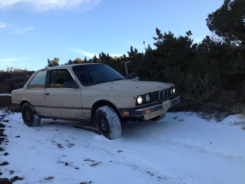

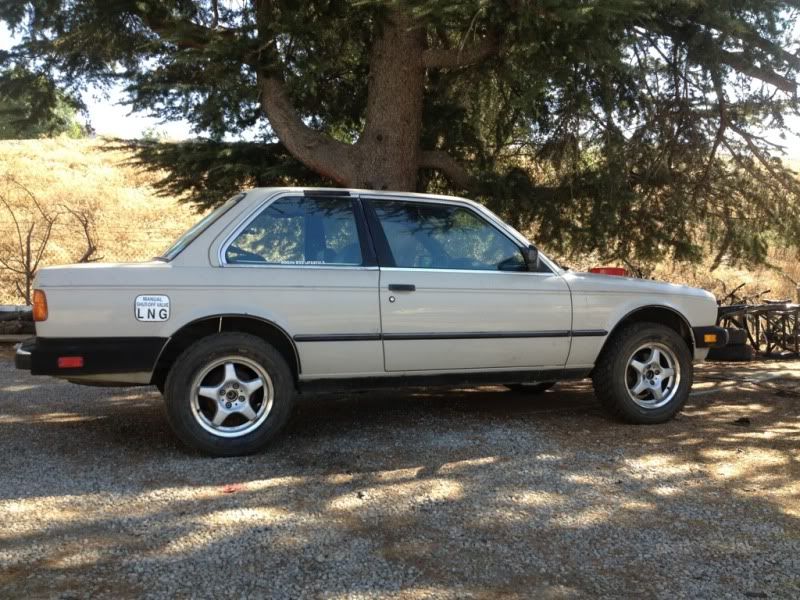

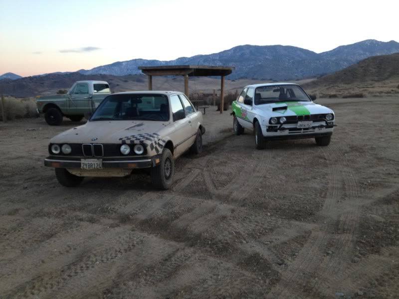

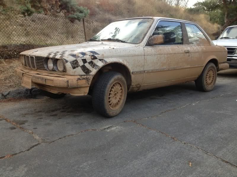

Since there is never enough pictures around here
