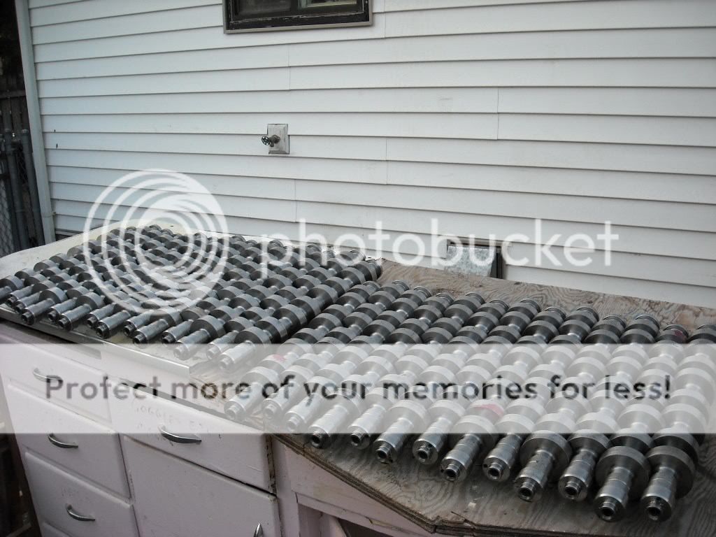

Yep they do have a good rep..
Now being a long term engine builder and having seen PIKLES of flow sheets for the motors we muck around with AND keeping in mind the "pretty damn good" rule-of-thumb that "max valve lift= 1/4 of valve diameter"......
I sure as hell see very little point of cams with valve lift into crazy degree when flow charts show a flattening out of flow at oh say 11.5mm for something with 44mm valves.
in other words let's say a head is flowing 220 cfm @ 10.5, then 223 @ 11, then 226 at 11.5, and then 228 @12 and maybe 234 @13mm
For a piddly few more cfm we have huge packaging problems: valve spring may not have the travel, spring rates start being hard to do and even lobe to head interference or bucket diamter is too small and cam lobe rams into the side of the bucket...all kinds of problems for a 1-2-3% increase in flow...
Rum, very rum some of these crazy lift designs...
Oh and BLOOODY PRICEY they are too .
That price is what led to me making these (under contract for a specialist Volvo shop)
Here's some completed:
Here's a nice side by side of a stock Volvo cam and a common Swedish rally oriented profile:
Nice, eh?

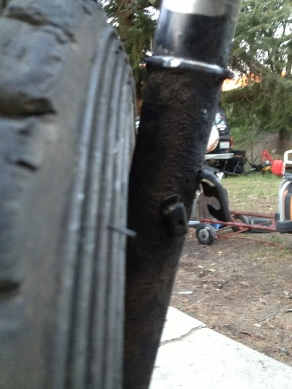

As for the Picture IM BONED on clearance I really thought it was gonna be more, John V maybe I can run a shorter spring from your collection? As for the struts I havnt gotten those out of my other e30 yet but I would have no problem sending them away and matching them to THE BEST spring I can fit in my area, I dont see it being a problem as the Bilstein HQ is local and they rebuild them with a valving of your choice if you know what to pick. Another guy mentioned "rally" to them and they said they knew just what to build them up to... But never said what spring to run so thats pretty much useless. The car never got driven to my knowledge so we dont know how it all worked out. ANYWAYS!
A couple responses to earlier threads.
The car is very high but only because it has a Double stacked strut top hat to gain ground clearance and still has noticeable droop. Even thought Im picking serious rally guys brains the car is used on more of a "pre runner" or "fun car". Love me hate, at least im not in a pickup.
My clearance problem is now an issue and I might get a low offset wheel and gusset up the strut so incase I do get some clearance a bent spindle will have a harder time rubbing the tire on the spring.
Anyways thanks for the help and hopefully I can get this semi assembled.
