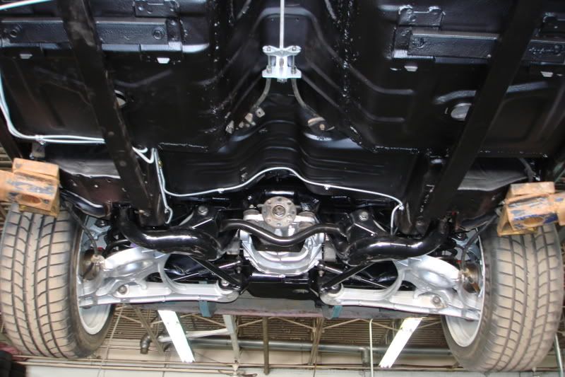

Well, the IRS out of an 03-04 Cobra is pretty much a bolt in deal. This pic gives a good idea of clearance...Looks pretty flat with plenty of places to mount delrin(or similar) skid plates. I'm pretty sure the suspension has more down-travel than show, that just looks like it's limited by whatever shock is installed:

Bolt in is nice buit man am I wary of IRS. Designers seem to be "too clever' and if there's a short link length somewhere I know it'll bite you in the ass when trying to make travel
Maybeeeeeee tho..
I know they always weigh a fair amount and how will you beef up those aluminum arms if they turn out to be like taffy?
See we knopw a well located 5 link rear works 100% hunk dory, just give it some loooooong links for shallow arcs..
Do we know the IRS shit will work and be as strong?
Known vs uuuuuuuuuuhhhm, maybe.
