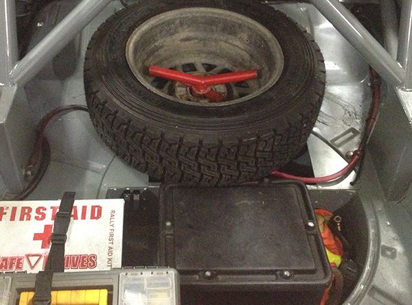

i did something kind of similar. when i got the rabbit the OE fuel pump crapped out and it was under the car in a really hard to access spot. I decided to install two aftermarket pumps in the passenger compartment, in a box, under the spare tire.
i only had to fab two sides of the box, since i used the spare tire well. be warned that if you use all AN stuff it will be super expensive. like, i could of bought another mint rabbit for how much i spent on this fuel system....

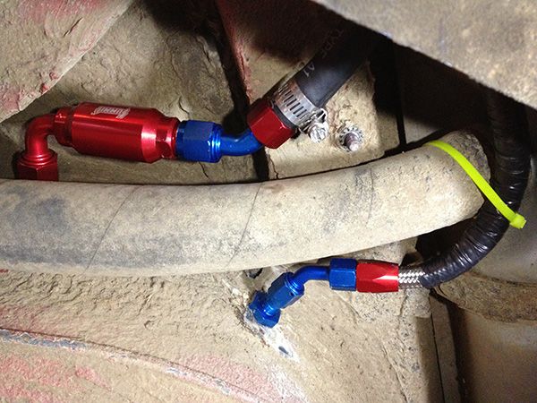

the line up top is from the OE tank into the wheel well, and the line on the bottom is the pressure line exiting. i also put a shut off on the line right after it exits the tank. i would recommend that, if you ever have to work on your fuel system and you happen to have a full tank of gas, you will be happy you have it.
here you can see the box under the spare. it still needs a lid, but that is easy, i am sure i will get around to making it the night before the first rally of the season at 2am...
i also put the fuel pump switches there on the panel on the left. i thought it would be a cool spot for them, but after getting some good testing this weekend (as good as possible with the snow on most roads) i think the switches need to be moved to the dash.

That's a nicely done box there. And I'd like people to take note of how the spare is secured in; it is a positive type of retention....2 straps across the tire is not, unless they keep the tire around a fixed stud or eye through the wheel center.
