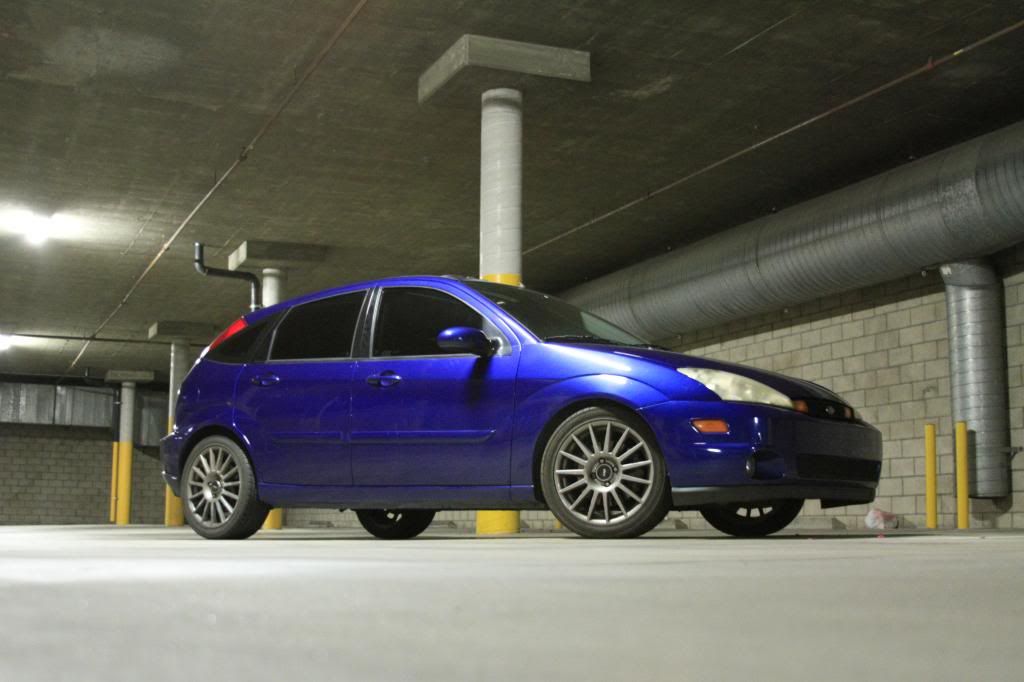

liv3mind
regestered this morning, im a member on focaljet but find the rally area quite lacking in info. anyways finally picked up an 04 svt focus 5door of my liking to start my rally build ive been kicking around in my head for a few years. I plan to make my first event the Porterfield #4 rallycross at Glen Helen on september 7th and 8th. Then hopefully some stage stuff if i can find some within reasonable driving/towing distance (probably desert/primm stages in december if memory serves me correctly) the car sould be going in to be caged late july, between now and then the plan is to get some jvab coilovers ordered up. then wheels/tires and harnesses/seats. Anyone wanna fill me in on how to get the car setup on logbook? i have the nasa/RA specs for the cage for my fab guy, just need to know where to get it signed off after completion. idk what the classes are now but last i checked im wanting to build the car as a gr2 class pos. here is a pic of the car as it sits now.
pretty color. How many miles on that poor SVT in there? Have you thought about Duratec when that blows its brains out? Those Duratecs are n-i-c-e....uh hum!
yeah my fav color, 1 of 48 made in 2004 (eap package) and i hate when people dont use them for what they want. its got 98k on the clock, just serviced timing belt and intake boots etc, im not sure about the duratec swap, its a possibility, although i had my sights set on a high comp itb setup on a spare 2.0 block that i need to source (maybe il find a duratec and try to finagle my head onto it haha). who knows what the future brings, hopefully i can get at least 20k out of this this revving the everliving piss out of it in gravel though.
