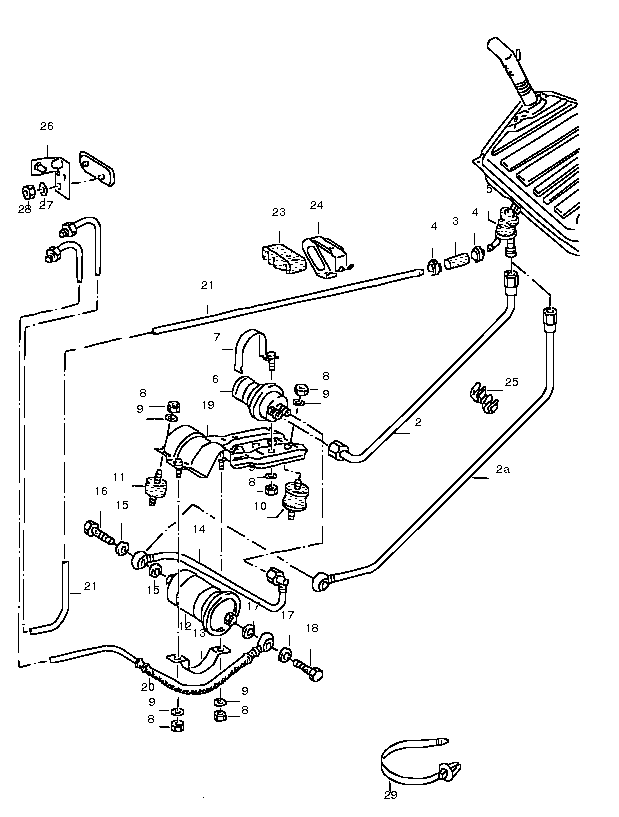

Regarding the fuel pump... Is there any special work that has to be done converting over to an outside the tank fuel pump? or is it just stick a hose into the corner of the tank and mount the pump in the car?

That's right, forgot that the cq was in tank gotta love the other B3s winking smiley. Where does the outlet come out on that again?
It comes out under the car, at the front of the tank. Sort of just behind the rear seats. I was thinking I would run a line out of the same spot and right up into the car and mount the pump somewhere right there where it pokes out. That would leave maybe just a few inches of flexible line under the car, and above the subframe (kinda), driveshaft and exhaust.

Should be fine. Sounds like how I would approach it. Should be recessed pretty well up there(assuming the coupe has the same hollow space up under the rear seat area) , but I might throw a small shield over it to deflect rocks.

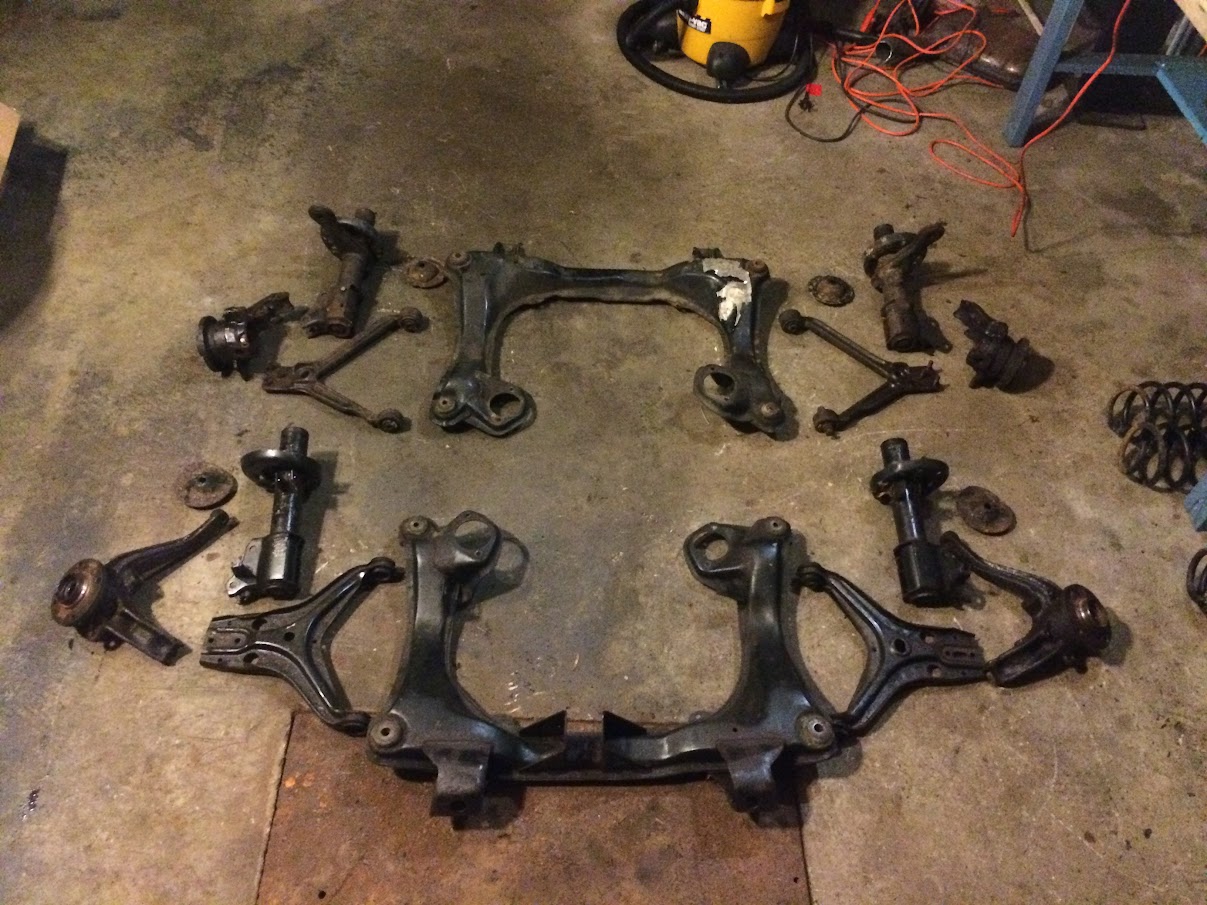

quick update here. All the pieces to the puzzle ( - sway bars and links)
Spindles are getting the hubs and bearing pressed out early next week.
quotes out to some sandblasters in the area...
Stamped arms, subframes and diff mounts to be welded up soon!

New bearings have been pressed in and 70% of the suspension has been refinished with POR15:
