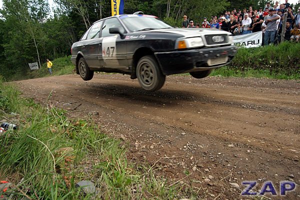

We ran a 90 Sedan quattro for a bunch of years with the 7A. More power would have been nice once in a while but it was still a super fun car.
(Shot of the guy we bought it off of from the Baie)
Atlantic Canadian Region Rallysport: http://www.rallyeast.ca - Ledwidge Lookoff Rally http://www.lookoffrally.com

OjNK
Ah that's awesome. Would love to hear more about what worked and what didn't while you were running it.
What's that cooler up in the front in the bumper? I'm guessing it was still an NA motor?

Re: Audi CQ Rally Build
August 21, 2015 12:41PM
Previous owner had a (S2?) turbo motor stuffed into it. We bought it from him with the 7A back inside. Most of the pain we went through while owning it was dealing with the frankenstein legacy from the swap.
It's a tough old bird. Still competing today with the guy we sold it to. drivetrain was pretty stock, though he did add the vacuum rear diff lock from a 4000(?), don't really know the technical specifics on that but it worked. Biggest problem we had with the thing was that the 90Q Sedan had different brakes that appeared to be utterly specific to the 90Q20V Sedan and went out of production a long time ago. Replacing all the front hardware with CQ bits so we could actually find parts for the thing was on our list when we sold it.

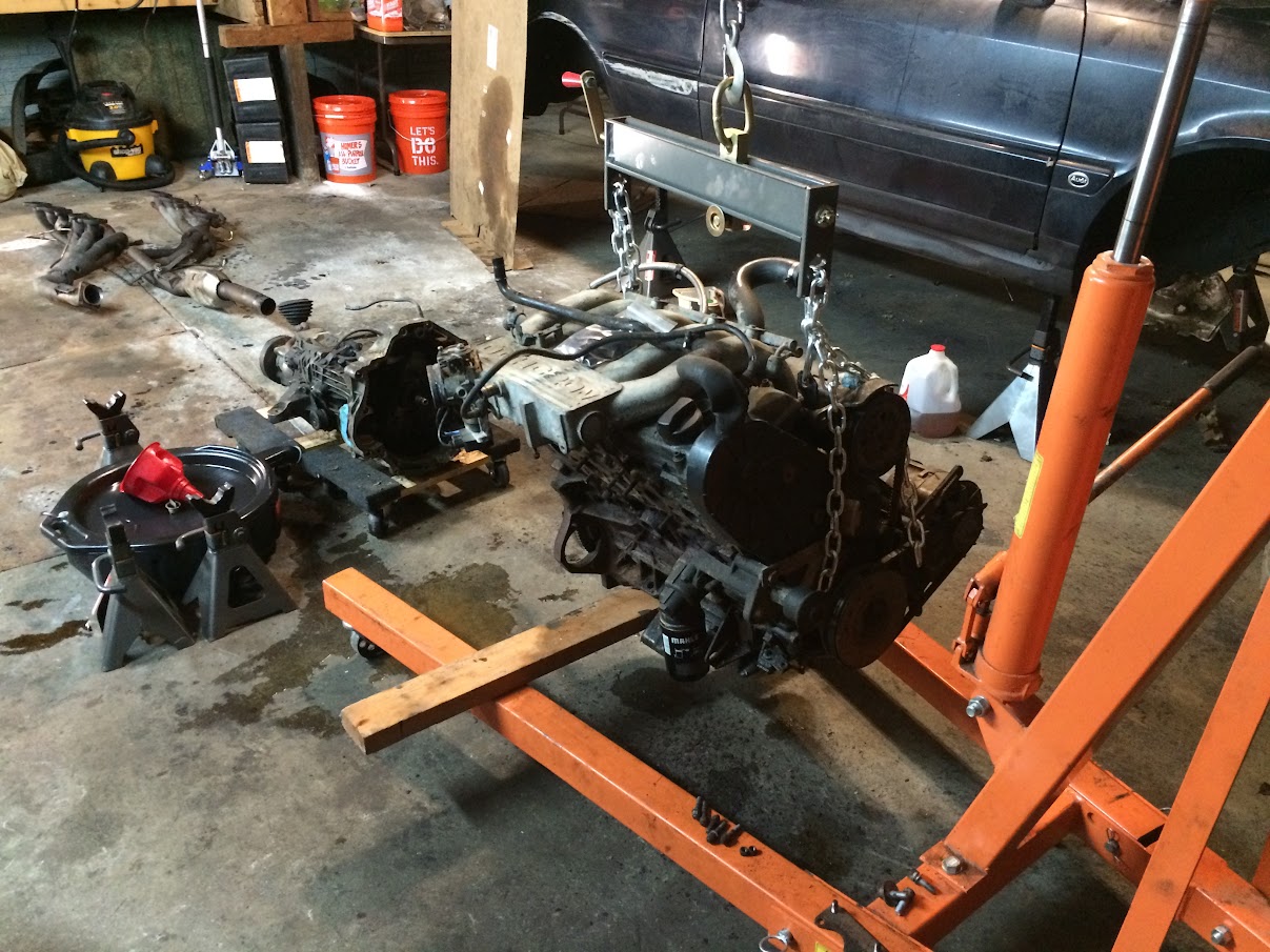

Getting some work done this week. Got the tranny and motor separated for the first time. Got the tranny drained, the exhaust manifold off - only one stud broken off in the thread! sad smiley
Still messing with the wiring, I think? its getting close to where I can pull the harness out of the car and slice and dice it up.
Need to spend some time cleaning up the motor - its a fire hazard in its current state with the amount of leaves, grass and acorn shells sitting in the nooks and crannies.
More fun to come, need to order clutch soon... ($$$)

Cutting up the harness is a pain, my condolences to you. I gave up within the first hour and made one from scratch. I used clutchnet for my clutch, but I've recently heard of a couple people having issues with getting things on time from them or lost orders. I had no issues but YMMV.
Also note in this movie that the factory does away with the top two trans bolts. Makes the job a 100 times easier to remove and install.

i have heard that buffum used large zip ties in the lower bolt holes

Ah, from engineering perspective, I hate the thought of doing something like that...
Not ruling it out, I'll probably take a closer look upon assembly. Crazy...

They actually cut and plate the top of the bell housing to clear the steering rack as well. Also notice the trans mount on the tail of the tranny. Mounts to the tunnel instead of the normal chassis mounts. No ears in front to hog up all the room or mounts on the chassis to get in the way of exhaust. Pretty slick. 15 min gearbox swap, pretty crazy lol.
