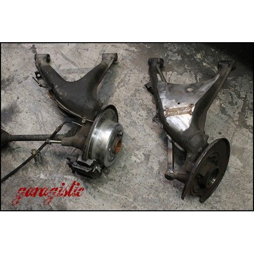

As weak as those LCA's look, while its out of the car it would be easy and cheap to have steel plate reinforcements welded in. You could swiss cheese and dimple die the plates for less weight and increased strength while you're at it.
I'll do that! some thing like this?

Exactly. I would go as far back as possible, without interfering with travel. Don't for get to hole-saw, and dimple die them for increased strength. It will also make it easier to clean out, so you don't have dirt. mud, etc... sticking up there causing corrosion issues over time.
Sweet will do, Thank you for the tip!
