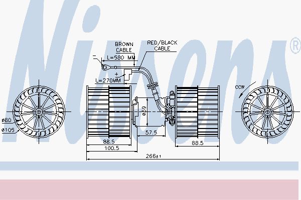

The sooner you can ditch the OEM blower the better. Last I checked there were no rebuild kits and finding a "good one" is near impossible.
The Summit brand universal heater is WAY more than adequate. I'm curious about he little ones with a PC fan on them.

That's why you do what you do to pay the rent. Your horison is too limited and you don't even know it...
This took less than 3 minutes to find:
http://www.ebay.co.uk/itm/NISSENS-Cabin-Heater-Fan-Blower-OE-Quality-87071-/122212555939?hash=item1c746f9ca3:g:aEUAAOSwXeJYHRVL
NISSENS Cabin Heater Fan Blower OE Quality - 87071

That is why you should not be advising people on things beyond your limitations.
Certainly this would be better and ultimately cheaper than buying some whatever thing, fucking around fitting it and then like so many brilliant ideas, finding its inadequate...
Unless of course you like buying some whatever thing, fucking around fitting it and then like so many brilliant ideas, finding its inadequate...I can't tell.

That's a good deal on the fan!
Swapping to the Summit heater was needed because the ecoboost was occupying the same space. It fit's well, and it's way lighter. But yes, there are options out there.
Re: Yet another Xr4Ti
April 05, 2017 01:52PM
Robert Culbertson
Yeah a good deal.
You missed the part about how lousy your knowledge about things is and your poor searching skills.
And that means maybe you should tone down your statements about what others should do and fill in more of WHY you do the things you do..
Something more fleshed out like "Well since we wanted to put in a latest verson Direct Injection Duratec thing and the head has a buncha shit hanging off the back we had to ditch the stock blower assembly...so we had to search for something different"
Then those who are NOT doing that engine are NOT led to believe that there is a problem with just an ordinary US AC model or the Euro non-AC blower... Hell, this guy Matt is English and he could easily avoid custom fab and have a friend back home take a chance on a second hand blower for 10-15 Squids--a friend could just jumper a used one and listen before sending.
And avoid wasting time and effort on something that may not work worth a damn.

But then again nobody bothered to inquire as to the reason why I am putting one in and jumped to an erroneous conclusion.
I want to have as little crap to go wrong on the car as possible, having heater controls operated by vac lines are crap, stupid slider controls that have seized due to moisture, noisy blower motor and a crapped out blower motor resistor are a few things found so far.
Now for $150 of my monies I can get a really simple water core with a low power consumption fan attached that will blow warm air, far far far less than trying to find all of the above pieces from the scrap yards of Europe and then hope and pray that they all work as intended and blow warm air.
As for the heated screen, only 100 loonies more than a regular screen (which I have to replace due to extensive cracks).... but with the added benefit of flick-a-switch demist which after a water splash or an early start in the Rocky Mountains is a fantastic feature.
