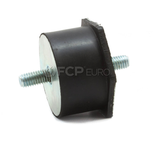

If you go this route... I like to mount them a bit lower for more exhaust clearance and it makes working on the car much easier.
Untitled by robert culbertson
Or you can keep it simple and use this, Volvo 160 motor mount:
MTC 1206612
Or this, 70s-80s Jaguar XJ6 motor mount:
Uro JLM1009 https://www.amazon.com/URO-Parts-JLM1009-Engine-Mount/dp/B0066RVFJG
