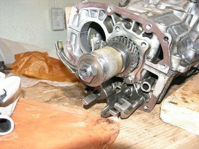

The Kaaz is going into a coverted awd to fwd subaru trans for my '93 soon to be group 2 Impreza fwd. The clutches on the fwd trans are weak and there are no final drive options for the fwd gearset so I am changing out the whole thing for a awd clutch, LSD and 4.44 final drive. should be fun.
Here's a pict of the conversion: a fwd rear case won't fit over the 5th gear shift fork so the center case is going to get blocked off at the back.

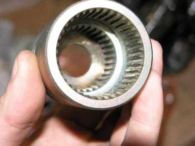

like this?
or this? one side is complete... shim would go between cone spring and clutch disc. big washer looking thing is cone spring
