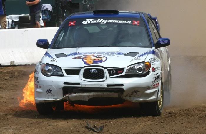

This is what happens when you crunch the filter on a subaru:
Well, actually the filter was fine, it was just that the exhaust manifolds got pushed back into the filter and broke the pipe off from the block. Took a chunk of the block with it. Oppsies.
Of course it did take a few good hits to do it:
Watch as he enters the stadium and hits, see the little red light next to the tach that comes on? Thats the oil pressure warning light...
I fixed it now, though. At least until he lands on the nose 3 times in a row again.
