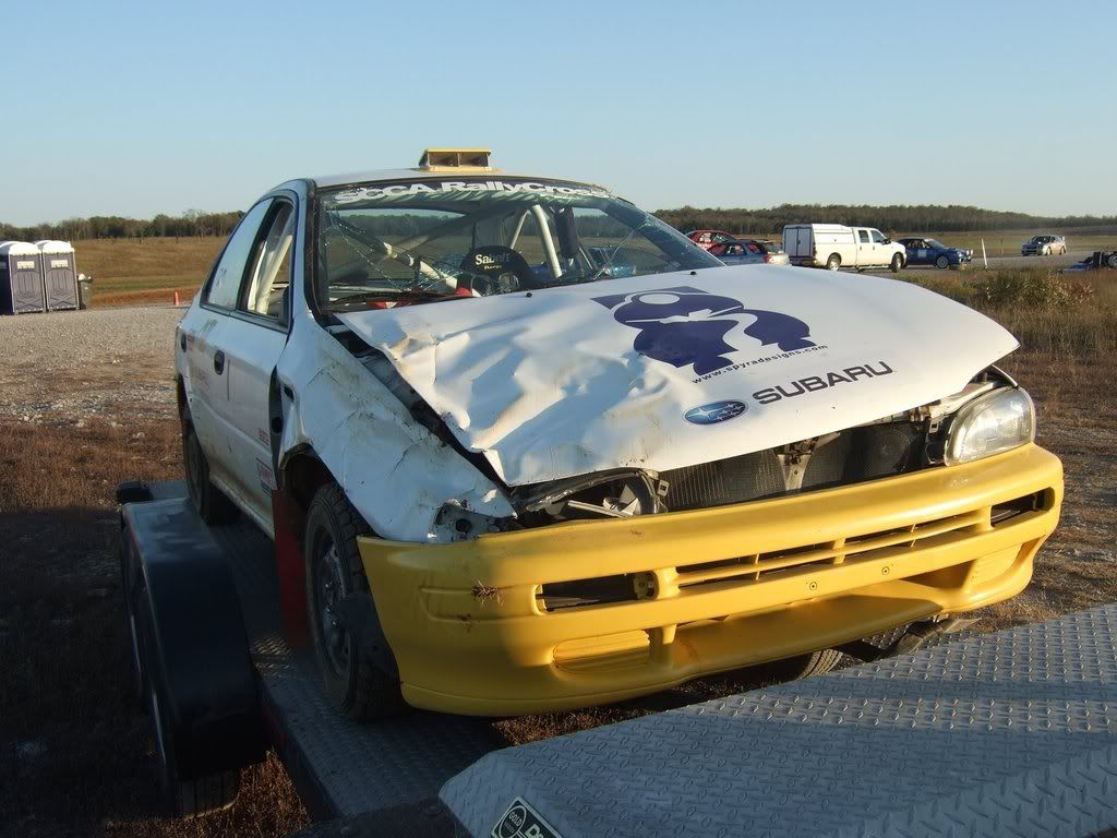

Having not even made it to one stage rally I already need a reshell from a roll at an unstated event (no one was hurt luckly). There is no noticeable damage to the cage, the front passenger and rear drivers strut towers are bent about the cage attachment points, the roof is twisted and the rear deck has a kink in it. There isn't any major paint flaking from the cage junctions. The current plan is to rent a plasma cutter and get the cage out. Once a new shell is acquired what is the right order? Strip, seam weld then chop the roof and install? Is a body rack required (I don't have one) or just a well supported shell, shouldn't it fit back together once the cage is in? Advice is appreciated.
Here's a picture to tide everyone over.

I may be talking out of my hat but it doesn't look bad enough to require a reshell.
I'd spend some quality time with a porta-ram set, come-along (chain and backhoe) and a couple of stout trees, get the suspension points back to approximately where they need to be and then if you can get the wheels pointing in the correct direction work out the cosmetics.
Help from another ralliest skilled in the art of post-race "adjustment" would probably get it rolling straight within a few hours.
Looks like a roofskin, rear quarter and some creativity would make it right -- no point making it too pretty, you built it to put dents in...

The "adjustments" side of things is a little new to me but the tree and backhoe thing seems familiar. here's the other side, you can see the tweaked rear deck as well. how's it look?

that does not look that bad.
what are you refering to as the "rear deck"??? the "top" of the rear windshield? or the "parcel shelf" (where the speakers would go)
If you are talking about the "top of the windshield" this is EASILY replaced on these cars with the roof panel. Go wrecker hunting and you can find a roof panel.
The drivers side pillars look a little ugly, but the right people can fix this.
It appears like all the wheels are pointed in the right directions...i doubt the front passagers strut tower is bent
Re: Reshelling advice needed
October 30, 2008 08:08PM
That's repairable for sure. My car looked worse than that one year at Defi. It turned out to be just dents on the body panels and the one front frame rail section was bent down an inch. Now I wouldn't even bother paying someone to do it. I'd just get out some tools of destruction and check measurements with the FSM.

went over the front end again today and what that shot of the strut tower is not showing is the bend in the frame at the front subframe mounting bolt. The front shot has the front bumper pushed down not because it is hanging but because of the frame. Time to rent a plasma cutter.

I'd hold your horses on that plasma cutter bub. That car looks definately repairable with at most equal, but probably a lot less work then cutting that nice cage out of there and swapping EVERYTHING else over to a new shell, oh and cutting off and re installing the roof on a new shell.
A good, Modern autobody shop with a decent frame machine like a cheif or a car-o-liner and a laser measuring system like Genesis or equivalent that is willing to work with you could save the trouble of having to remove the cage.
Like others said you'd be surpized what a front end loader, chains and trees can do but a professional gold class I-Car cert. body man can do wonders with a laser measuring system, a frame rack and a welder. You just gotta find the right guy thats willing to take on a project like this.
It's a unibody chassis dude. There is no real frame. Those pieces can be sectioned out of another car.
Seems better to me to fix what you've got then to swap everything over to a completely new car. Especially to take a nother car and still have to cut the roof off to weld your cage back in. Paint cost is inevitable either way.
Some one good could get that car back to you in 2-3 weeks.
The front doesn't look like it needs much more than a skirt, apron and a core support from the pictures. You could section everything on the right side of the car from the a pillar forward from another car. It's just a lot of spot welds to drill.

Kevin, sorry for your loss. It looks repairable to me as well. But, it's your money/project/comfort level, so do as you please.

You might be OK to cut out the right front and weld in a new right front and core support. But look carefully at the firewall/floor area to make sure it is not crinkled; it might well be if the right front is pusched back that much. If so, then the firewall crinkles would need to be straigthened and probably reinforced, else you may get stress cracking in the firewall/floor later. (And you might still even with reinforcing.)
Striaghtening the rear as is seems do-able with the right jacks and frame attachements.
Good luck!

Please don't cut off anything until after it's been pulled. Makes the job 2000% easier. Pull all the bent stuff out, then when it's close cut it off, if needed, often on a rally car it isn't. If you cut off a frame rail that is bent before straightening it, you'll have to weld the new one on crooked and then pull it into position.

thanks for the advice guys, I think I have better idea of how I'm going to approach this, and where to tie the backhoe to. got the front fender off yesterday so here is the real damage to front... fender braces were on my to-do list.
