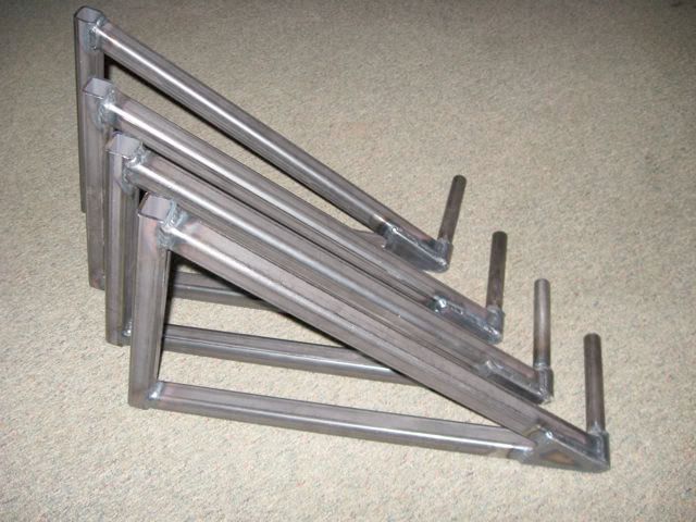

my dad made these up over the weekend. we used 3/4 rod and 1x.120 square. they are 18" bottom to center, just need to ad the sill plates to the car now. what do you think?

Any thoughts about using square vs round tubing? Seems like I see a lot of the pro's using round

Square tube is easier to cut, miter, and get fit right.
Round tube is sexier...

Ford has used both, I have done square, VW seems to like round on later stuff, square on earlier.
If the fit was decent square plug ins into square tube would certainly resist rotation better, maybe that's good, maybe they'll bind when jacking down one end.
