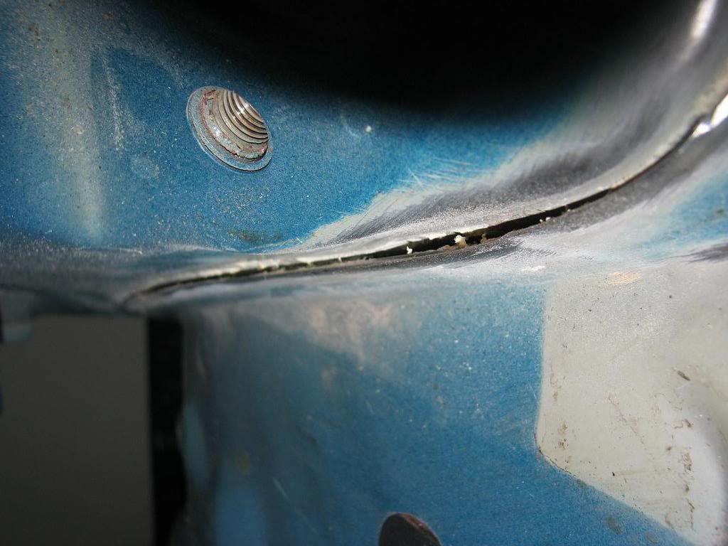

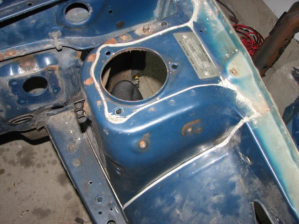

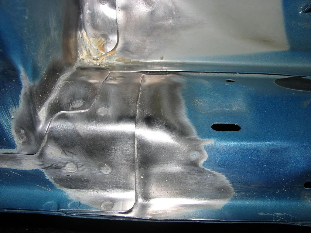

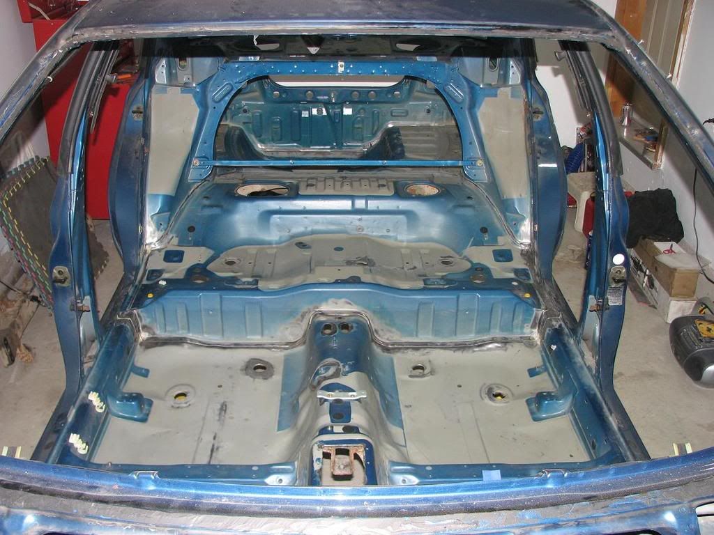

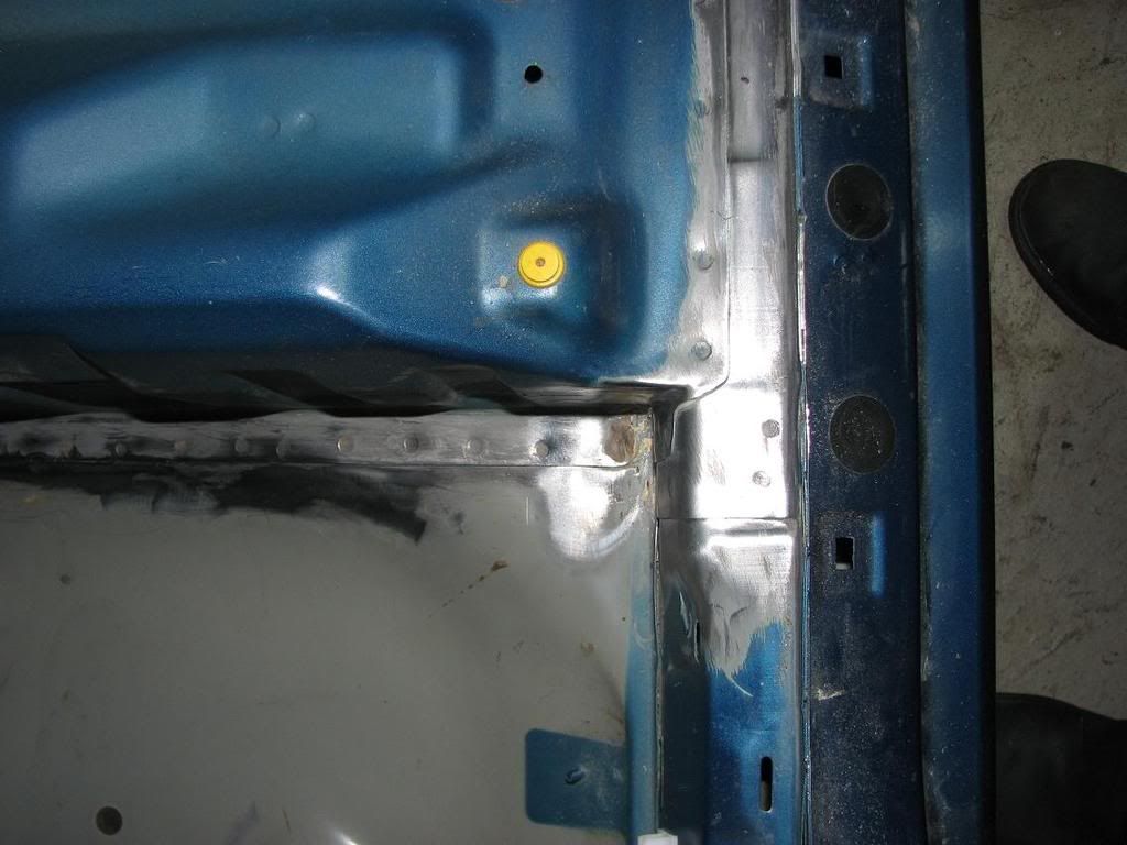

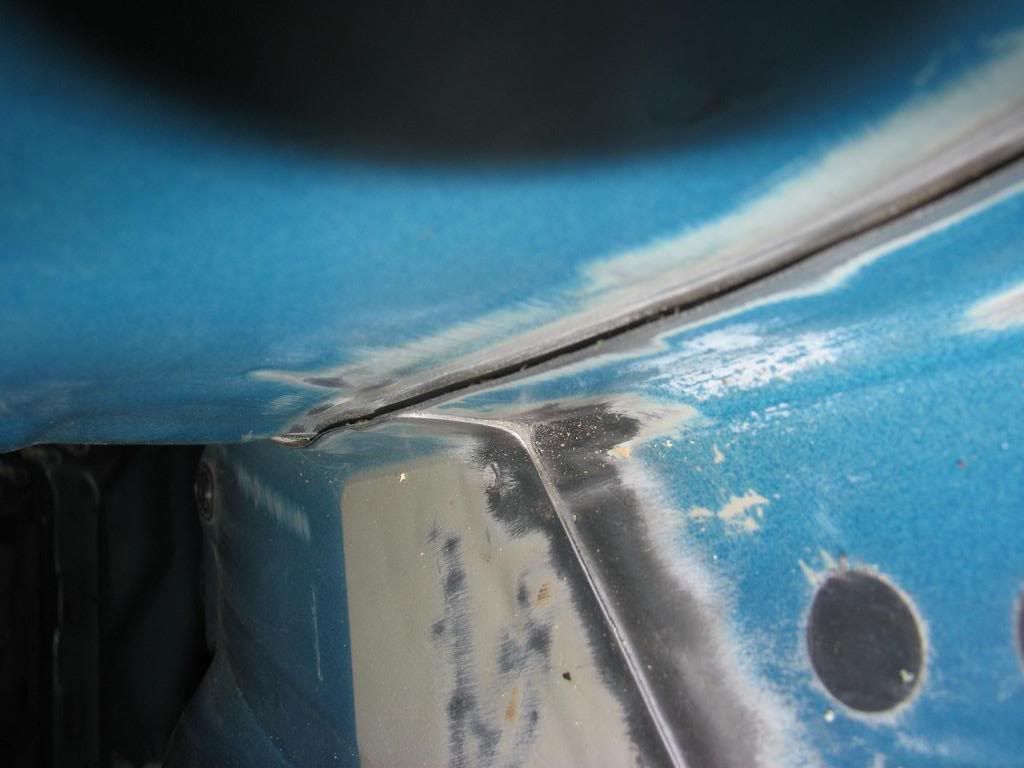

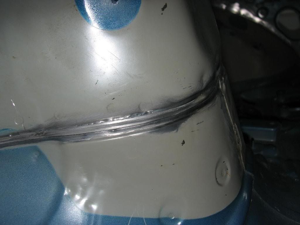

I'm kind of new here and just beggining to build my first rally car. I started stipping the car a couple weeks ago and now I'm preping the shell. I've attached a few pictures to show you where I'm at. The car is a '94 Impretzel.
My questions are:
a) I'm doing my best to remove all the visable seam sealer. I'm using a razor and scraper for the large gobs, a small flathead screwdriver for the smaller stuff, and finnishing up by dragging or picking out the rest I can get with a set of dental picks. Then I'm wire brushing the area to get the little stragglers. Here and there I think that some sealer is remaining will that mess up a MIG weld? Am I doing allright preping the seams to be stich welded?
b) The goopy ruber like crap in the wheelwells, what is an efficient way to remove it? I tried using a wire wheel (crimped with 0.,014 wire) on my angle grinder, and other than it having a mind of it's own as to which direction it wants to go, I'm affriad it's going to be too harsh and damage the metal underneath. Is my fear valid?
c) What type of paint (type/brand) is best to use on the seams after they are welded? Self-etching primer? (oh, and I don't currently own any paint spraying equipment)
Anything you can think of that might be good for me to consider.... please share.
Thanks,
Daniel B

You got them pretty clean already but the seam sealer reacts badly with welding. Try using a propane torch and a wire brush to get the rear out of the seams. It's what I use. Also good for removing paint in hard to reach areas.
Re: Shell Prep Q's
February 02, 2009 03:25PM
if you have a 90 degree "dental pick" type tool, those work really well for digging out some of the burnt or even not burnt stragglers stuck in seams.
Re: Shell Prep Q's
February 02, 2009 03:41PM
You have those joints pretty clean....as clean...maybe cleaner than i got mine. The propane torch idea does work well...
I don't know how good of a welder you are, but once you learn the techique you should be able to do it...
turn up the shielding gas and have at it
