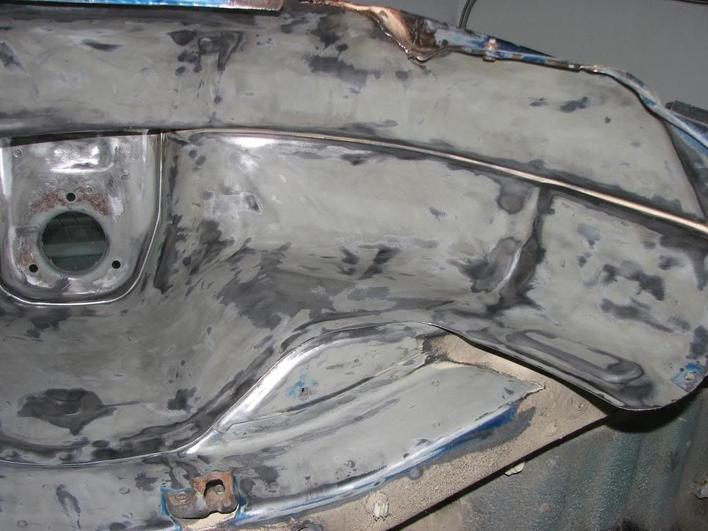

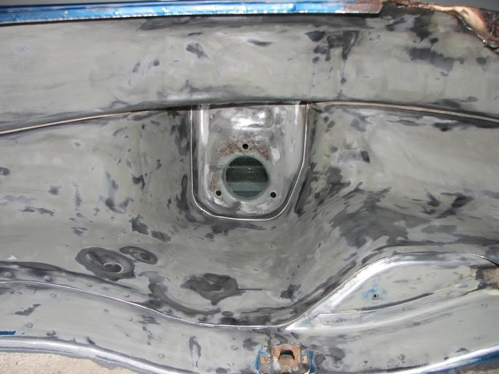

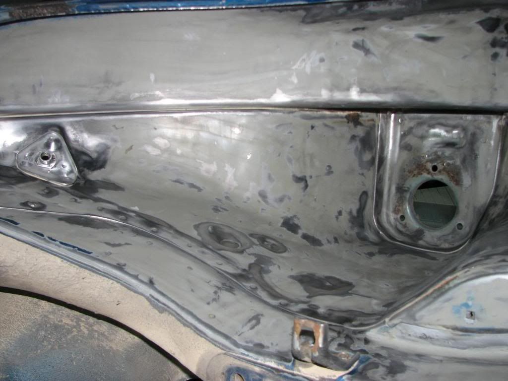

So, I had some fun with a 4inch cupped wire wheel last night. Took nearly 2 hours to do the one wheelwell. Now that I know what to do, I will probably be able to do another one in an hour.

Re: Shell Prep Q's
February 04, 2009 02:20PM
that looks all too famliar...
how covered in stringy, goopey crap did you get? look like Nuwan winking smiley?

Re: Shell Prep Q's
February 05, 2009 06:12AM
I felt like I'd stuck my head in a cotton-candy machine!
> look like Nuwan ?
Just like him!
> I'll get you the info for the paint...i think i
> have the spec sheet around. at the very least the
> can is still in the basement...
> Chris
I also learned that when a cupped wire wheel starts to give up the ghost, the end is near. When it started to loose it's quills, I felt like I was being attacked by an bionic porcupine.
