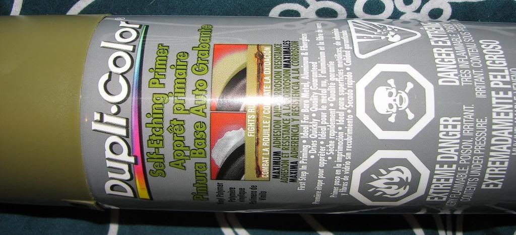

So I went with this primer in the wheel wells:

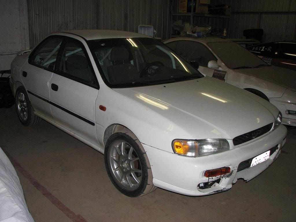

And, as far as shells being considered consumable... That's what this is for:
EDIT: She is my definintion of 'seat time (on a budget)'. RallyCross/Track Day/Recce Toy and the next 'shell'...
