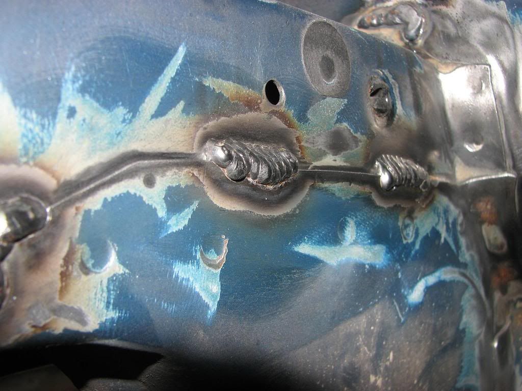

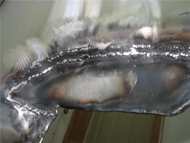

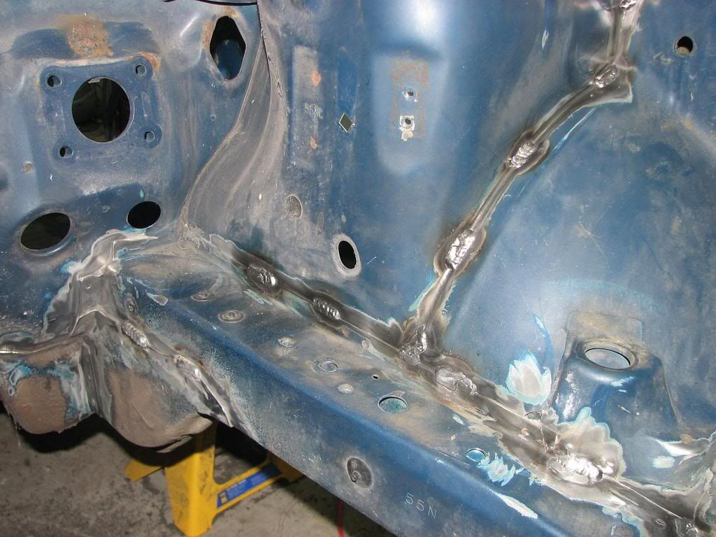

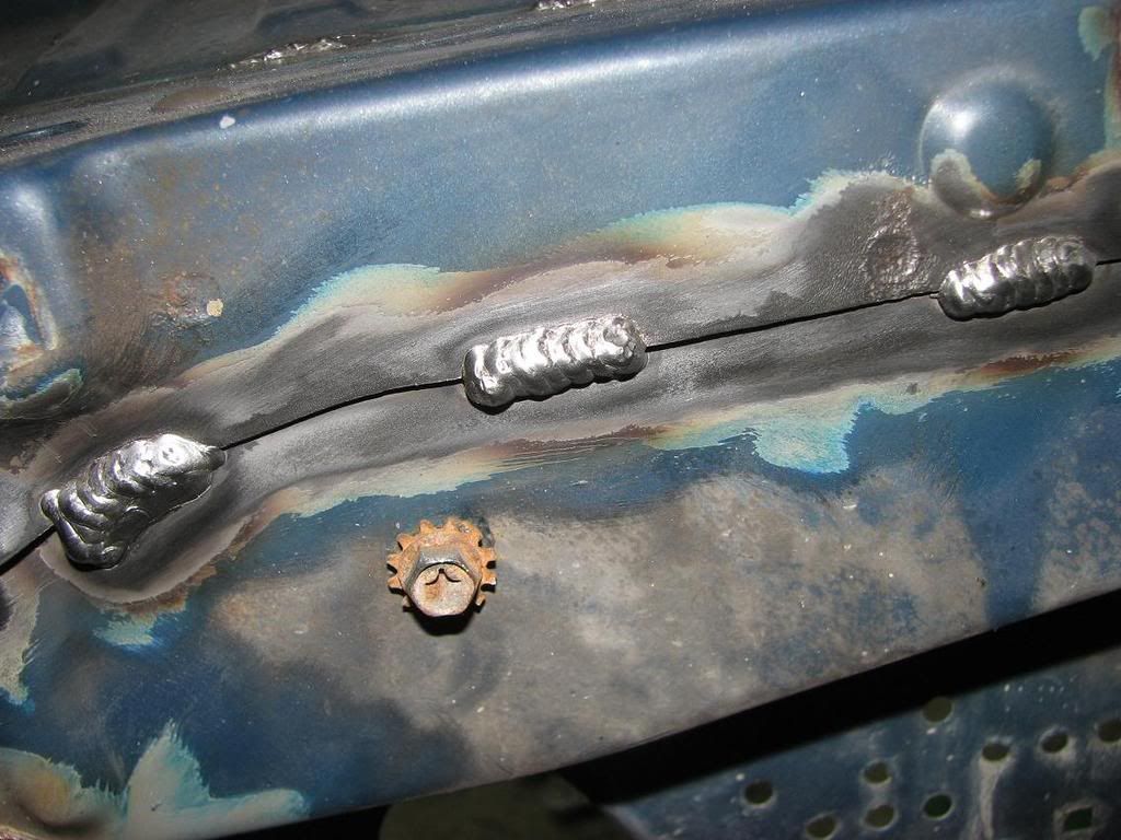

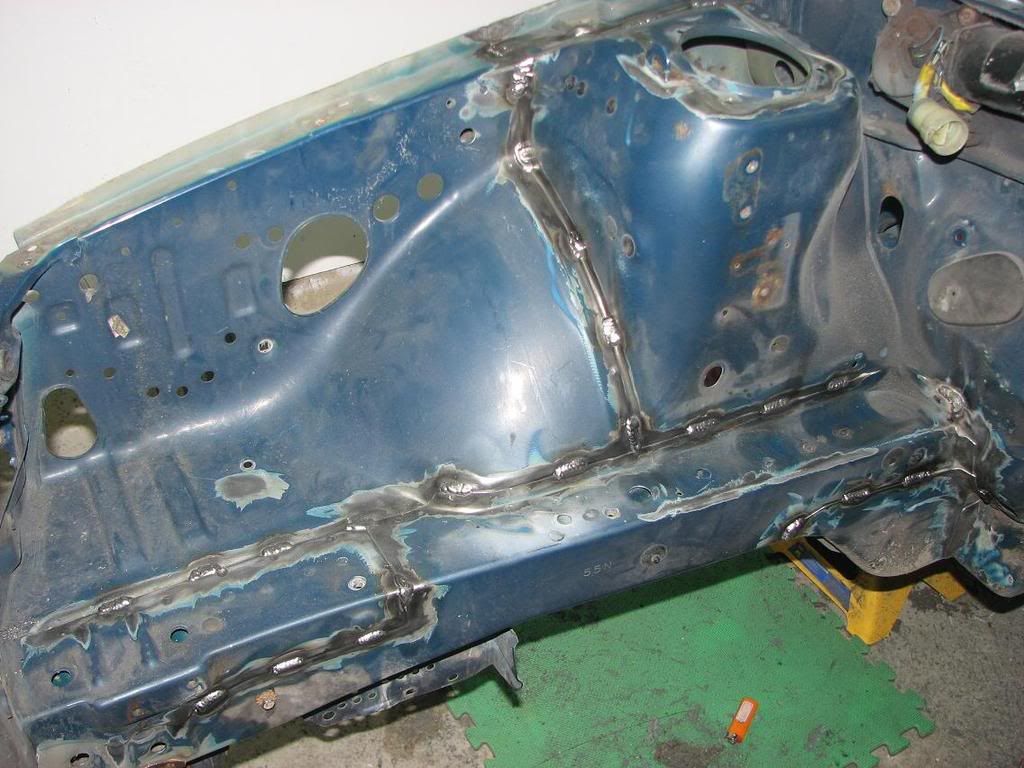

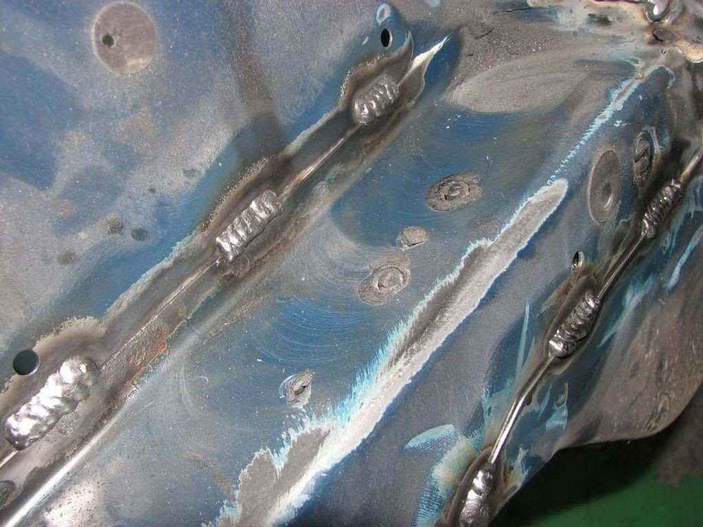

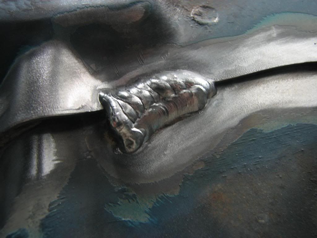

So as of today I've been welding for 4 weeks and I'm looking for tips. My first welds were embarassing so I'm not going to post pictures of those... yet. Here where I'm at, how am I doing?

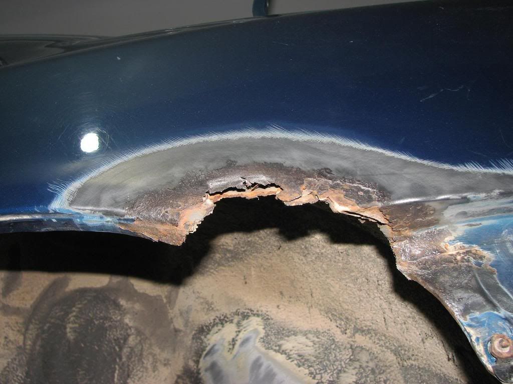

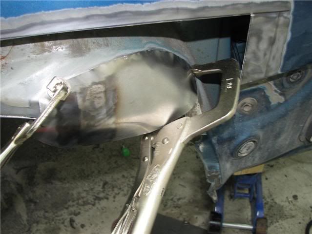

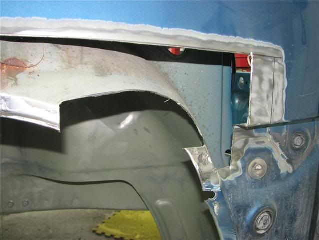

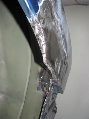

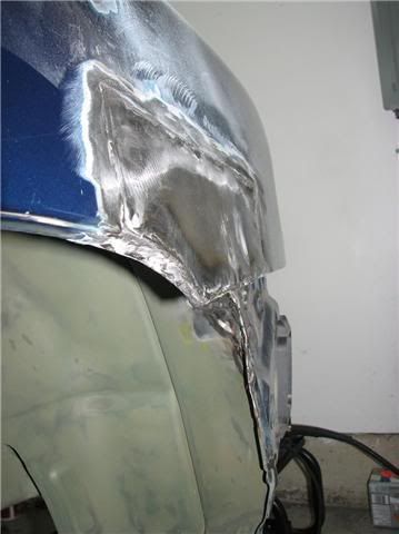

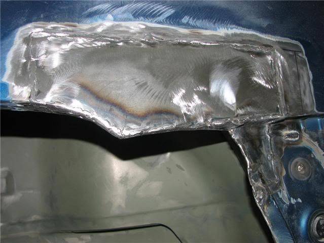

My first attempt at body work...
March 06, 2009 02:42PM
So I had some rust I wanted to deal with and I thought this would be the best way to learn to weld - dive right in...

Re: progress pics
March 07, 2009 01:22PM
In some of those, it looks like you need to turn the heat up a bit... play around with the settings. You don't want to be burning through, but when your welds sit really 'proud' like that (concave out), it implies poor penetration, too much wire,... a pool that isn't hot enough to really melt the base metal, but is being fed lots of wire.
Next time you're doing seam welds, try adjusting the wire speed and output after each weld (or every two welds). Perhaps make an adjustment to the welder, then do two welds... one slow, one fast... change up the technique a bit... see what little changes result in the most improvement. Sometimes changing the angle on the tip is all it takes to burn a little deeper.
Overall they're looking pretty good though. And bodywork on thin sheets like fenders can be difficult... the newer the car, the thinner the sheet metal, the harder it is to weld. One of the keys is having good base material... if you're trying to weld to thin rusty crap, you'll just keep burning through, and will be throwing weld at it. Sometimes it means cutting out more than we want to, or holding a second piece in behind to act as a backing strip.
The other thing with body work... just how good do you want it to look? Are you going to tear that fender off when you hook your first ditch?
Re: progress pics
March 07, 2009 03:06PM
Thanks. I'll try playing with the settings today. I'm pretty sure I know what you mean about the 'proud' puddles. I can see somtimes when the wire is feeding it seem to just flow right into the base metal forming nice shallow pools. Other times it just pools on top. I've been nervous to touch the settings but I can see the value in adjusting them to see the outcome.

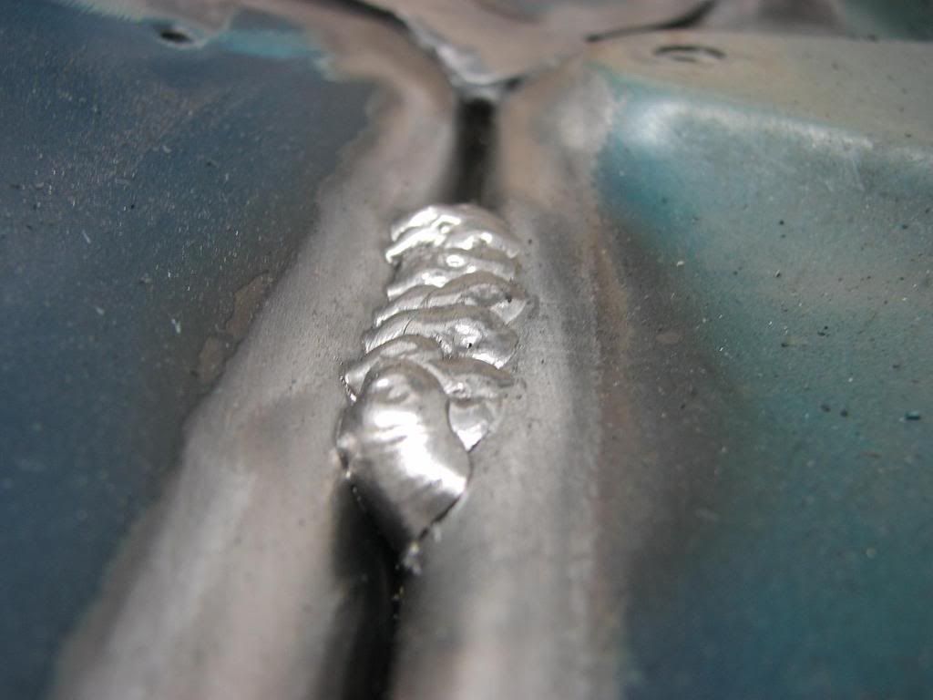

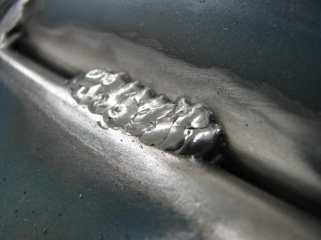

Not a good morning for me welding wise! Question... ?
March 07, 2009 03:15PM

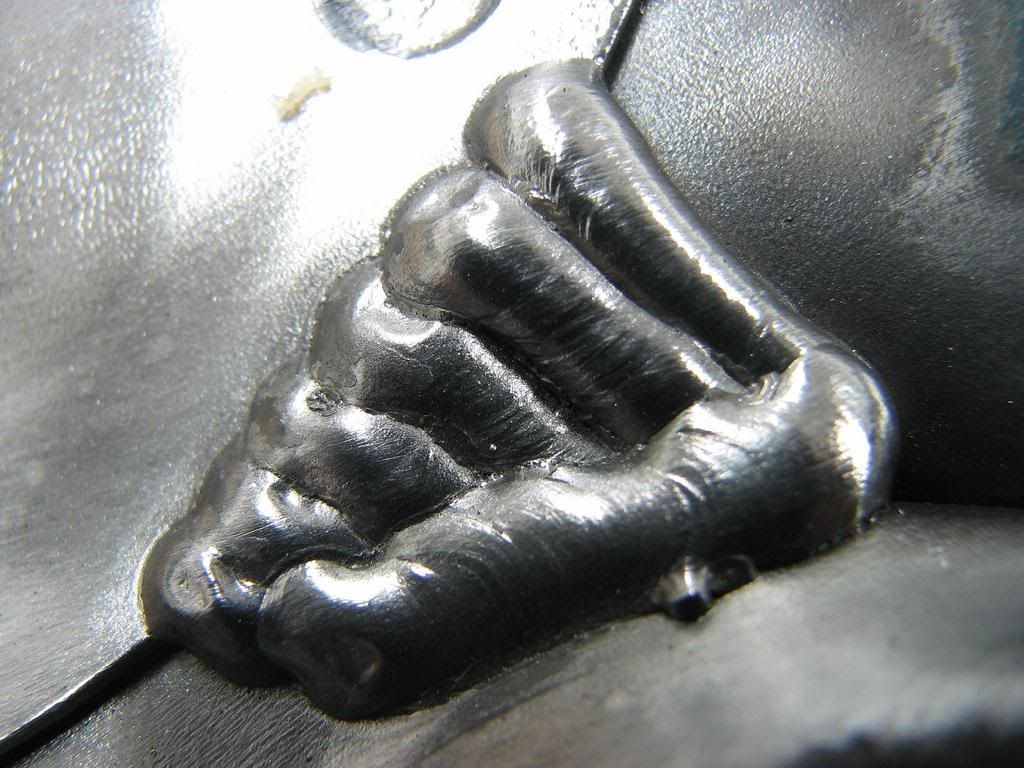

So I'm stiching inside the front wheel wells and I just can't get things right. I keep getting these 'volcanos' forming in the puddle almost immediately as it cools. If I hit that area again with a puddle it just snap-crackle pops into these shitty ass welds!
By 'volcano' I mean these hollow cones that grow out of the puddle. I have had a FEW before, but I'm getting these things like two out of three welds!
I assumed that the ones I got in the past were from sealer left over in the seams. I've done everything the same to prep this area - although, the seams are slighly different and the sheet metal fits together better.
Also, the approach angle of these welds is different, for the first time I'm not welding down on a flat surface or a vertical area...
BAH!!!
I'm holding off on welding for now, other things to do and I'm getting frustrated...
As always, any help is greatly appreciated!
tmachnik
Tom Machnik
Location: Edmonton, Alberta, Canada
Join Date: 01/31/2008
Posts: 78
1985 VW GTI
Re: Shell Prep Q's
March 07, 2009 06:01PM
Those "volcanoes" can also happen if you haven't cleaned off all the undercoat or sealer from the backside of the panel.
Re: Shell Prep Q's
March 07, 2009 08:11PM
That makes a whole lot of sense!!!
So I can assume that they are a result of contaminents (?) and I'll bring my propane cylenders in from the garage. I was trying to burn the junk out of the seams this morning but the garage is too cold and I have no propane pressure and so no real heat.
I did not even think about the other side of the metal. I just clean off large deposits of sealer/rubber so they don't catch on fire.
Thanks!

March 17, 2009 02:44PM
Okay, so what does one do to prevent rust in an area that is sort-of sealed?
For example, I've got a small area in my rockers that needs to be re-skined. If I cut the rusted metal out and weld a new sheel in place, what prevents rust from forming on the bare sheet inside the rocker (or at least the area where any coating has been burned off from welding)?

Re: Shell Prep Q's
March 17, 2009 07:53PM
I'm no expert, but I'd say you have to wax oil it or cut holes in from the inside and spray bomb the crap out if.. but since you have no real way to clean it let alone get a good even coverage, some sort of anti rust oil product is your only real option.
