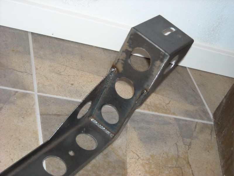

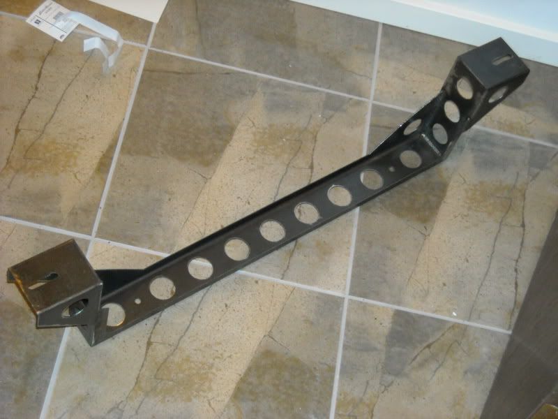

Re: project xr
March 18, 2009 08:51PM
Lost a nickle bet to john on how heavy my radiator holder was to his aluminum one.
I said it was 8 oz heaver turned out it was little over 2 lbs at 3.5 lbs!! I think
i can live with that

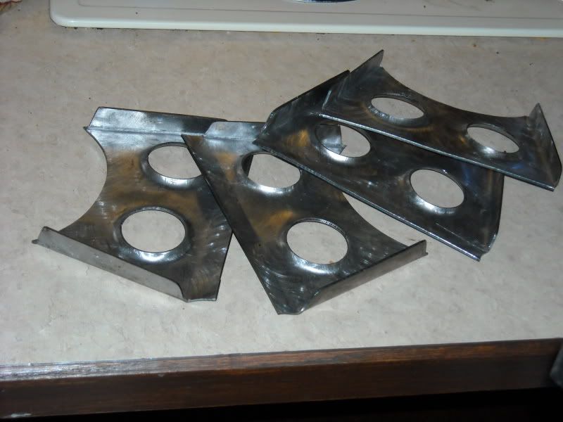

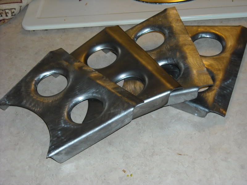

Also did up some tower braces they turned out nice I'm really trying to find time
for my two cars there needs to be more time in the day!
