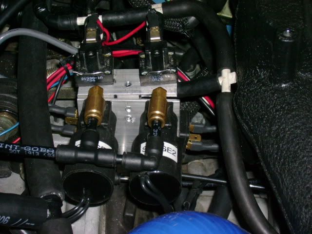

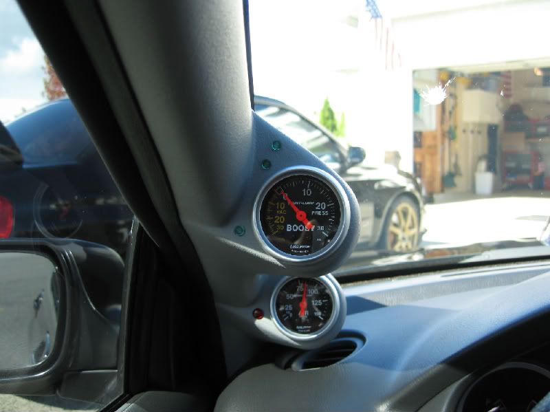

I have ran water injection for about two years on one of my cars, it was a turbo car so the gains were pretty easy to see, the kit was very simple I built It all myself, and it worked great. I used a shurflow pump and accumulator in the trunk and fed the system using an OEM STI IC spray tank. The system was a two stage system, 10psi a small jet came on and at 15psi a second jet came on but bigger in size. I used adjustable boost pressure switches and normally closed solenoids. I put in a line pressure gauge to keep an eye on the pump. The system s operation pressure was 100psi I also setup the low level sender on the sti tank to trigger a LED, on the gauge pod for low water, and pump power, stage1 and stage 2 solenoid power led’s to help me keep an eye on the system. I tested it monthly and never had a failure of any kind. What I liked was the simplicity of it compared to other kits, and for rally I would go with something simple as possible so u don’t have some expensive piece letting you down, out on a stage. It’s quite possible to carry all the parts to this system as spares for under 200$ and under 100$ if you don’t keep a spare pump.
The LED’s for the low tank=red, bottom green= pump power, next green =Stage one, next green Stage two
The solenoids and the adjustable boost pressure switches.
