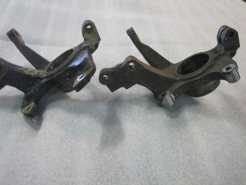

No, your setup is different, its typical FWD style just extremely undersized for 50 bhp much less whatever the GTX puts thru.
The torque spec for the type on the front of the Vodge Dolt or Adam's Toiletta, or Volvo 240, RX7s etc is in the range of 4-6 inch/lb. That's what I can do with thumb and forefinger.
I know the GTX set-up, and even have some front knuckles left over from when i did the big brake set-up on the GTX that Derek Bottle had, which might be yours (Do you have Willwood Superlites in front and RX7 calipers in back?) and if you are sure your wheelbearings are fresh and tight and you have any movement it could be that the knuckles themselves are worn out on their ID.

no shit?! you have the Bottles Special modified-for-Wilwoods uprights? Dude! I really need those, i trashed a front upright ad Doo Wops and was going to have to find some new uprights somewhere and then find some machine shop in portland to modify them. perhaps I will make a trip up to Seattle in the near future to pick those up, also have some work for William to do on the GTX.

Better find what we did which was some Fird.mercury something, shorter steering arms for quicker steering.

I sold my shit to Matt Manspeaker and I thoguht that DirkaDirkaJack bought that car (or the decendent of that car) so I thought your car had my old shit on it.
The front knucles are the front 2wd knucles off a 323 GTX also found on the Ford/Mercary Topaz.

yEAH dERKEK, HE HAS YOUR STUFF. wE TALKED AND SEEMS THE BOTTOM PINCHie BOLT lug IS FAWKED UP, (ooops BooBoo Anna has been on the Word Doc again and she likes Caps Lock) and the hole in the knuckle all wallowed out so the pinch function is lost.
I suspect the fact the struts have so much travel and the knuck rams into the arm and has too much angle at the ball joint is the root cause, so he's said he'd try and drag the shit up and see if we can do do some knuckles to let him reatin the big brakes.
Remember how i was all horrified how the knuck was hard on the arm at full droop or really the last inch or so?
That needs to be cured with droop straps of shorter inserts, and I just happen to have some somewhat shorter DMS 50mm inserts just over there.

yep, the brake setup on that car kicks ass for sure. As soon as my new uprights show up and i find some cash laying around i plan on heading up to JVL's to get the new uprights modified. hopefully in a week or two.

Getr those knuckles here ASAP, money is later.
The machine shop has time now, and i may be into the hospitale for serious ass surgery so hustle hustle.
