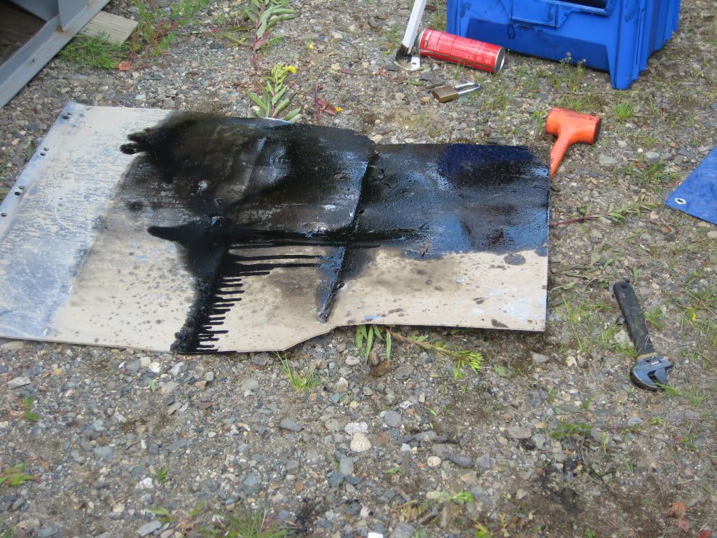

I think I may have bashed the co-driver's side horn up by an inch or so. I made a stress bar out of 1 in box tube but it just got flattened. I had a 3/16" aluminum skid plate anchored to the stress bar which did help disperse the blows a bit but it is now trashed along with everything else above it (with the exception of the gearbox, thankfully).
Any photos or details you can offer on the old demon rabbit would be great. I've already spent hours on your website but I don't remember seeing any of the front horn reinforcement.
Skidplate before: http://i225.photobucket.com/albums/dd32/Greasecar/IMG_0272.jpg
Skidplate After: http://i225.photobucket.com/albums/dd32/Greasecar/IMG_0365.jpg

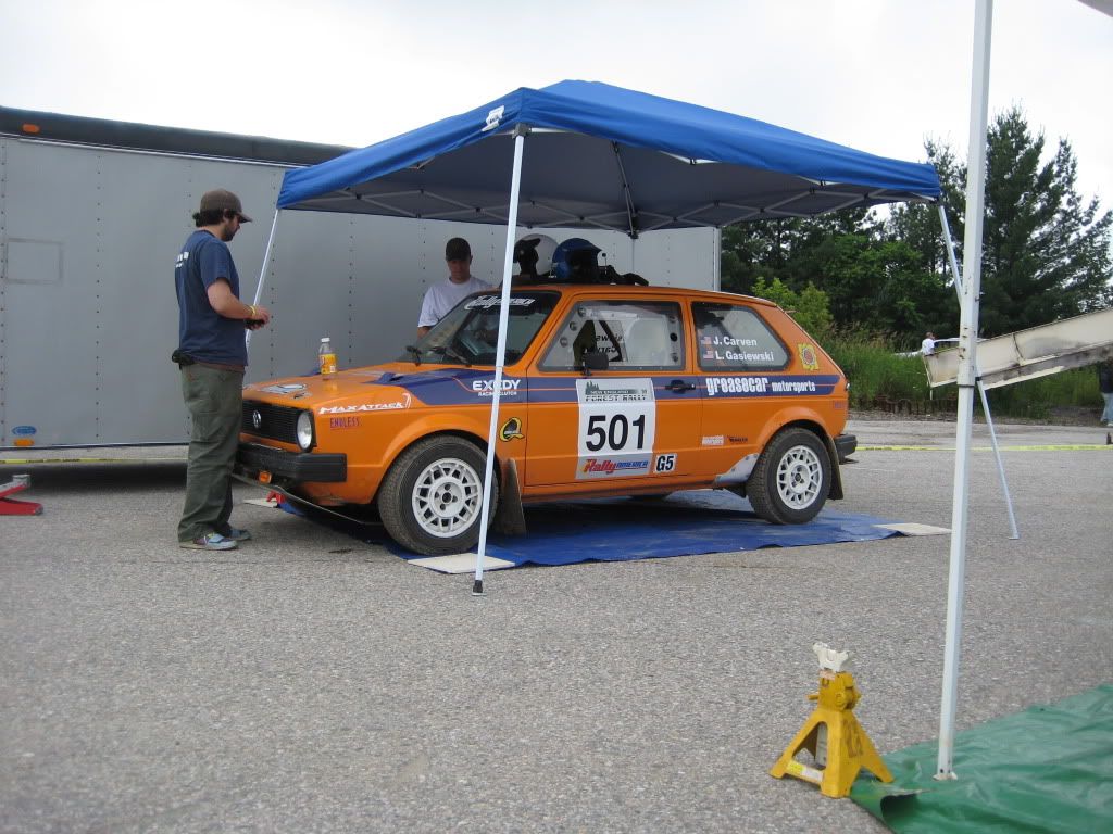

How it was sitting before the stages that beat it into submission: http://i225.photobucket.com/albums/dd32/Greasecar/IMG_0321.jpg

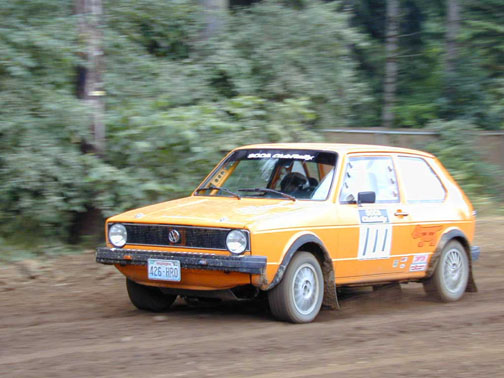

For those of you guys from the PNW, this was Townsend and the "Bunny Boys" old car and running the suspension that they put together. It's always been this low: http://p3racing.net/vw/rabbit/000903078.jpg

That's actually the first rally car Pete Van Bogart (Cascade Autosport) built and campaigned. Originally running a turbo motor. The thing with Rabbits is if you jack them up too tall they handle like crap and get too much body roll and tip over too easy. Probably you just need stiffer suspension than you have now, I wouldn't really raise it. Tom Buress' car was lower than that and I don't think there was ever anyone faster in a Rabbit.
