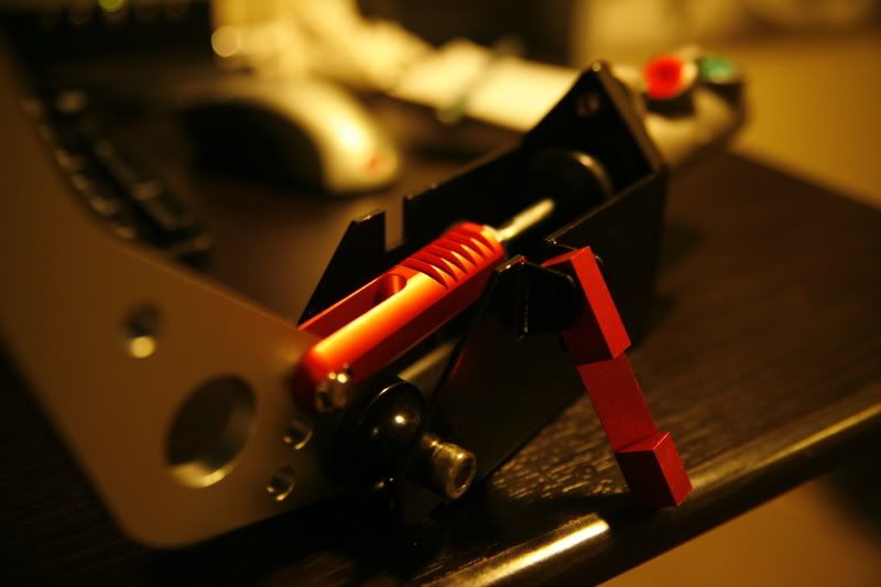

Any special techniques needed? Is it gonna be a bitch?
Everything is replumbed.
Front outlet on the master for the front brakes - T-fitting, and off to each front wheel
Rear outlet on the master - Adjustable Prop valve (bolted to side of Handbrake) - through handbrake master cylinder - T fitting - off to each rear wheel.
This is the handbrake i have
which uses this Wilwood master cylinder
http://www.wilwood.com/Products/006-MasterCylinders/004-CRRMC/index.asp
Edited 1 time(s). Last edit at 07/29/2009 02:09PM by Do It Sidewayz.

I do the dual master thing, so just gravity bleed until I get fluid leaking out of both rears, dont pump the handbrake. Then do the pressure bleeder thing to push the bubbles out of the handbrake, then regular pump the pedal and wrench thing with a friend.

Just let it gravity bleed onto some containers. No need to bench bleed anything, thats old wives tales.

I used a bit of gravity, and then just "normal" bleeding with pedal. Nothing fancy, nothing "hard" or tricky about it...
As long as the handbrake isn't touched, the fluid flows straight through it - thus there's nothing to it compared to bleeding a completely fresh "normal" system. That just means that it'll take a while to get some fluid into the hoses before you can start pumping the pedal. Gravity will take care of that...

Think i did a decent job of it last night. Think there is still some air in there, but i left it for a while to let the air work it's way places.
Pedal feels pretty decent.
