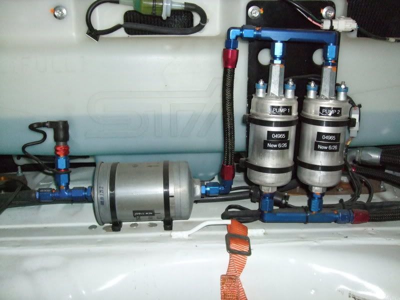

Heres a shot I took.
You dont have to use the million bucks worth of an stuff, but the basic layout will be the same. There was a switch up front to select pump 1, pump 2, or both I believe. I assume there was an intank lift pump too (premiere fuel cell) but I never checked.

This is a vermont car, isnt it? It's probably got a collector inside too, perhaps with the lift pump feeding the collector, then the high pressure pumps drawing from the supply there.
Re: need pics of dual fuel pump's
August 22, 2009 07:35PM
Yeah its a VSC built car.
The fuel cell was one system that we actually didnt have any issues with on the car, so I never got in to it to see how it was set up inside the cell.
> never checked.
Good chance with the 044's there is not a lift pump, they can pull quite a bit of suction. With that setup and the lack of a swirl pot it just seems they are adding the ability to have a second pump at a flick of a switch. So not the goals of some of the other dual or tripple pump setups.
The team Ive worked with ran dual walbros in the tank, that feed a surge tank then a1000 was the pressure pump. The dual walbros were setup like the 044's above, a they never ran together just if one failed you could flip to the other one. Little more cost but it worked. THe fine thing about the walbros is there failure rate at low psi <10 is very low and when u use them as a lift pump they can do it well. THe issue is they do not like to be ran at 100% duty cycle all the time, so having a way to control them is a must. If you cant then a bosch 044 would be a better lift pump choice.
