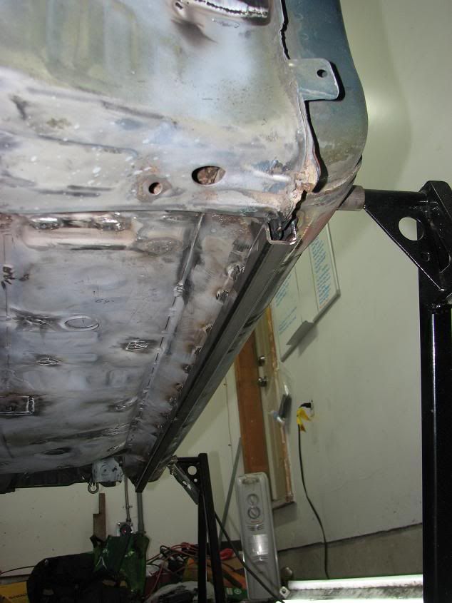

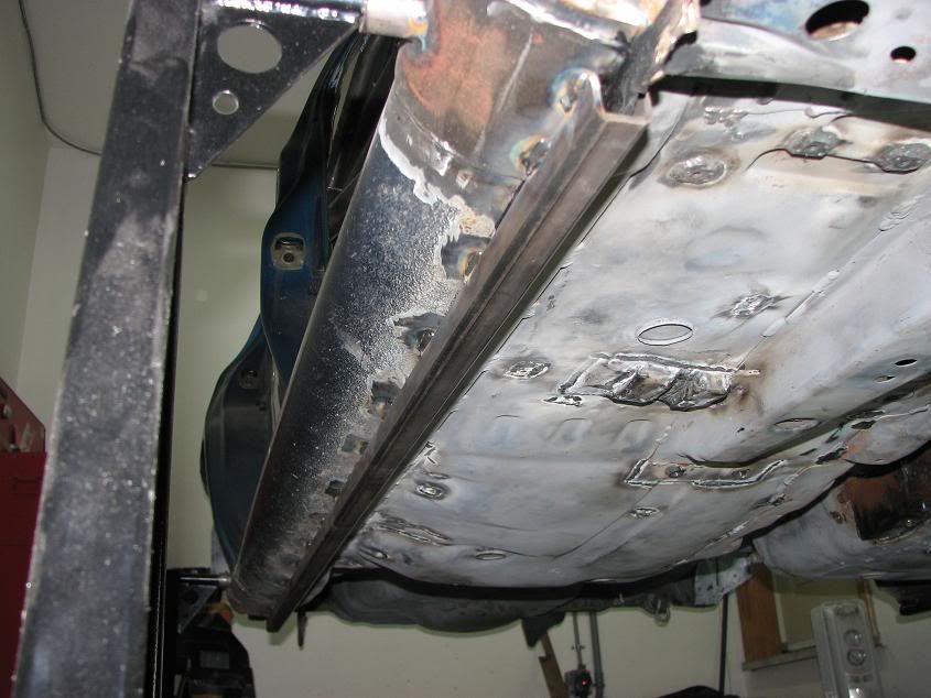

Re: Rocker Reinforcement - What are your thoughts?
November 12, 2009 02:05PM
I went with 1"x1" square tubing, 1/8 thick. I cut a strip out and profiled it to fit.
It added 14 lbs in total.
I like!
(I will most likely add a 'ramp' to the front to act as a skid plate.)
