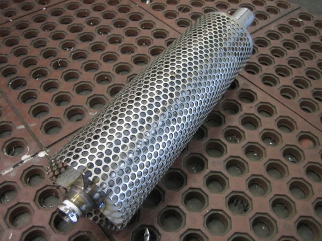

So doesnt look like the death ray will make it my way in time to start stripping shell #1. What do I need to make one? What size/thread fitting is needed. This thread is useless without pics!
Re: LN and death ray to prep shell
December 03, 2009 11:32AM
Usually 1/2" NPT but it really depends on what hose they give you with the tank.

Okay, death ray is here. Thanks John for letting it jet around the world, and thanks Jason for getting it here so quickly. Really am hoping to get both shells done this weekend. Both are stripped and on jack stands currently.
Airgas guys haven't called back. About to call them to get the shit delivered. Rottisserie is over at another shop and they've been a little flaky about us getting it from them. Backup plan is the queen sized pillow top that's currently sitting in my bedroom. Side benefit of that is having somewhere to take a nap down at the shop in the future. smiling smiley
From Airgas, do I need to request a hose.
What about an on/off thing to start/stop flow of stuff.
Can this be done solo, or best to do with friends?
Welding gloves sufficient?
December 09, 2009 04:38PM
No one builds a death ray like Tim.
You have to ask for a hose, they are short, like three feet, It would be really nice to get 2 or three and daisy-chain them if possible. The valve on the tank works great. It would be great to have extra hands with chisels and slag hammers while its cold. Just chill areas about a foot sq. at a time. A sharp wood chisel works well. BIG-ASS welding gloves. I said it before, frost bite HURTS!

You thinking what you're thinking you better get two 175 liter cans delivered, you'll go thru the one on Saturday and be stuck pounding the pudding on Sunday.
GET THE ROTISSERIE, you don't want to be fawkin ariund, you want to move quickly before the shit cooks off.
Also get a BIG fan to blow the area so you can see, you don't want to be running the gas while twiddling thumbs waiting for the clouds of steam to dissipate.
