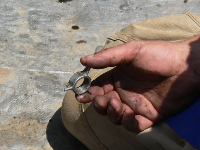

It does take a lot of nose landings to do in the oil filter on a subaru. Relocation isnt required, and a sandwich plate is easy.
Heres an example of what it takes to break off the oil filter in a subaru:
You can see on the 3rd nose landing (back in to the stadium) is where the oil filter breaks off and it loses pressure (warning light comes on.)
This is what broke:
I wasnt able to fix that on the stadium floor...damn!
The car had 1/4 skid plate with the usual prodrive style mount in the front. I guess it could have used another mount to the very front of the skid plate from the front bumper bracket area.
