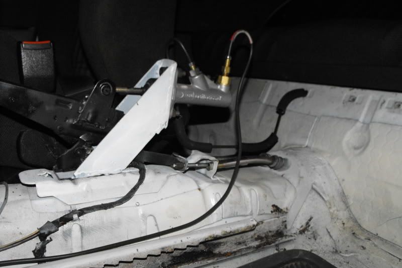

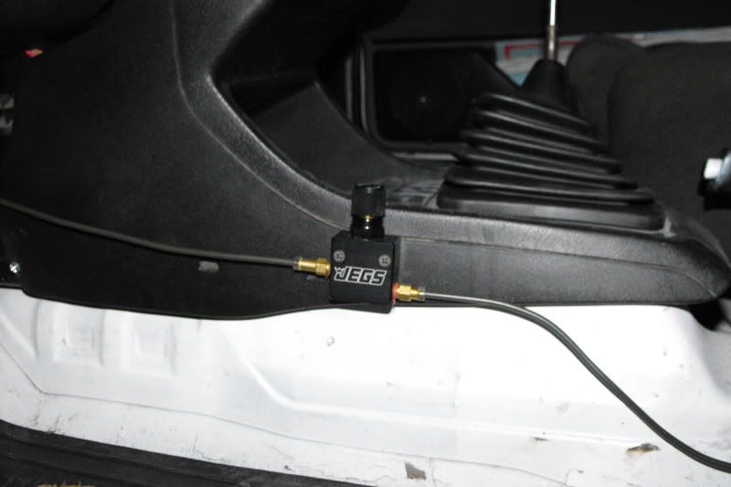

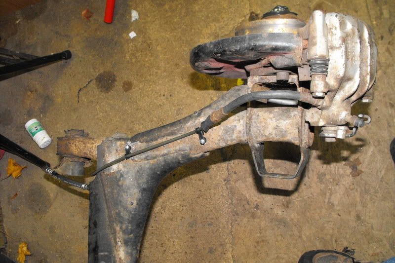

it makes sense the pads would be the first to fade, iam running rather docile pads for everyday enjoyment as well as the inevitable -5 degree days, here is my set up, another sunny after noon and i should have a roller and stopper again.
