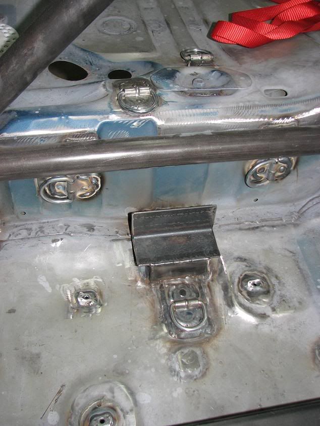

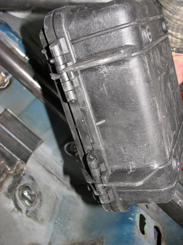

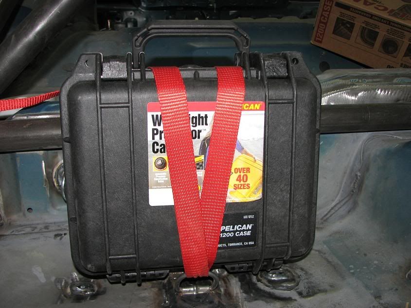

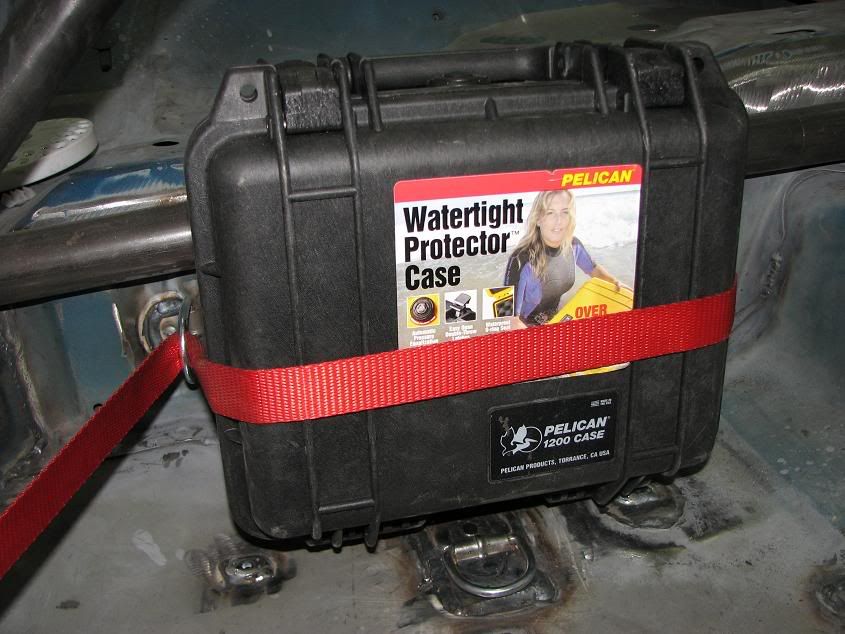

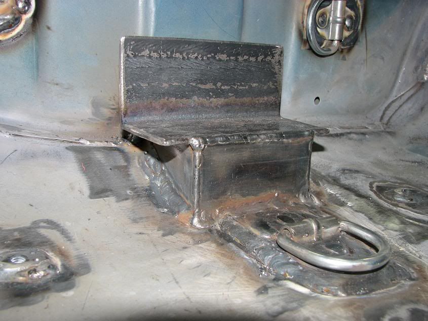

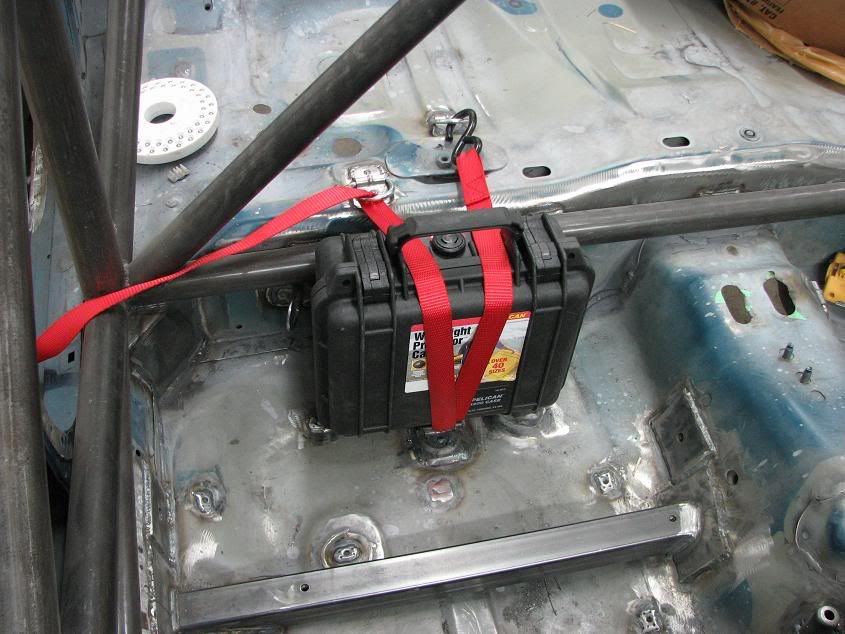

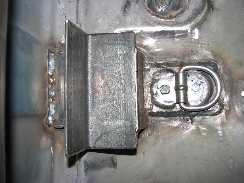

So I followed Chris' lead and found a sealed Marine box that fits the Deka/Bass Pro battery perfectly. But it was way too much money, so I got it cheap off e-bay.
I built a mount to strap it to the floor. (Yeah, I know... But I'm learning how to weld)
Did I goof? Is the mount going to get destroyed being mounted to the floor there?
There is a groove on the bottom of the box that the mount fits into:
Then the box gets straped in:
Re: Relocated Batteries
December 23, 2009 12:48PM
Daniel,
As long as it's secure you'll probably be ok.
But consider having to change that battery in a hurry. You will want to be able to just pop the top of the case, and pull out the battery.
I can probably grab you a photo when i get home.
