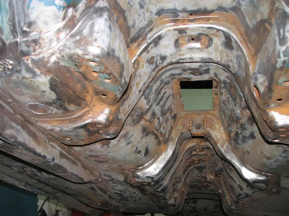

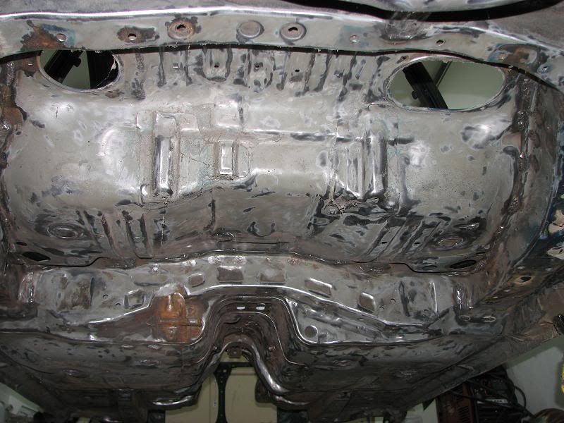

Where did you find the rust?
Was it the seam under the c-pillar? Inside the rear arches?
Re: And I swore I'd never touch acid again....
December 15, 2009 06:44AM
Here?
Inside arch:
Viewed from between the trunk and the rear quarter:
Inside passenger compartment:
> rear arches?
Yep and yep. They all rust there. The rest of the shell is really clean.
December 15, 2009 12:40PM
Here's what it looked like after using a wire wheel:
> wheel:
Wow! I can't believe how much rust there is on the floorpan. Of course it's basically 15 years old now....
Still, you'd think by now they'd have figured out how to slow the spread of that stuff!
December 15, 2009 01:05PM
It looked pretty good before I dug into it...
And, it looks pretty good now.
