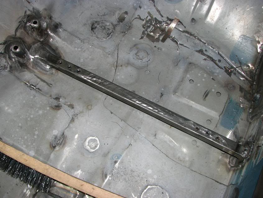

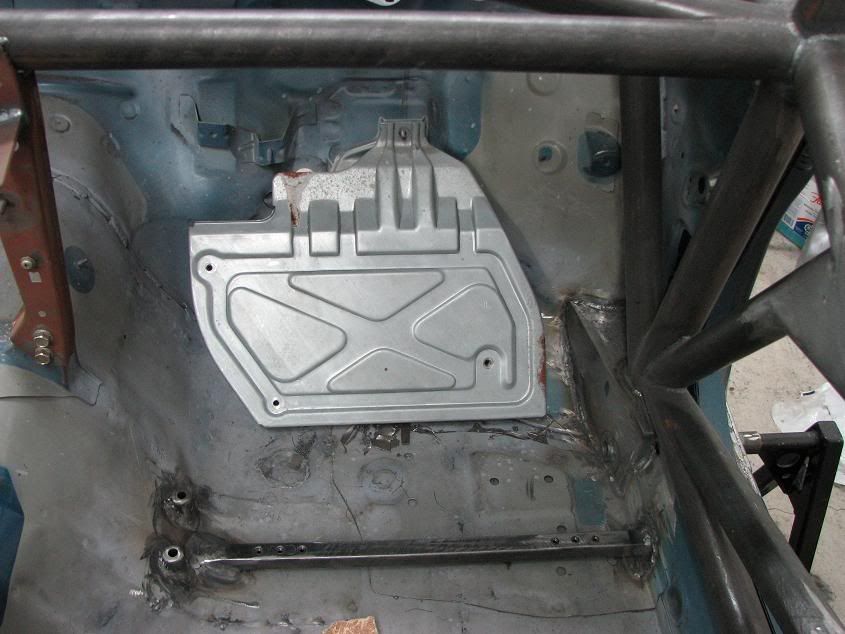

Here's what I've got now:
A square tube with six M6 weldnuts in it. The tube allows for a flat surface (other than the crooked floor).
I'm tempted to run anoter one across the floor in front of it, but can't commit.
I've broken the one in the car I co-drive for. It had a bracket welded to the transmision tunel. I didn't like loosing it.
The cage tubes are sort of "in the way" on the outside. I'd prefer not to weld anything to them.

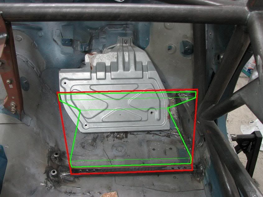

I was thinking about bending some aluminum sheet for the footrest and attaching it to the tube . Then bending another sheet in a "V" running from the base of the footrest to the ECU cover plate (see picture below). Then back to the top of the footrest.

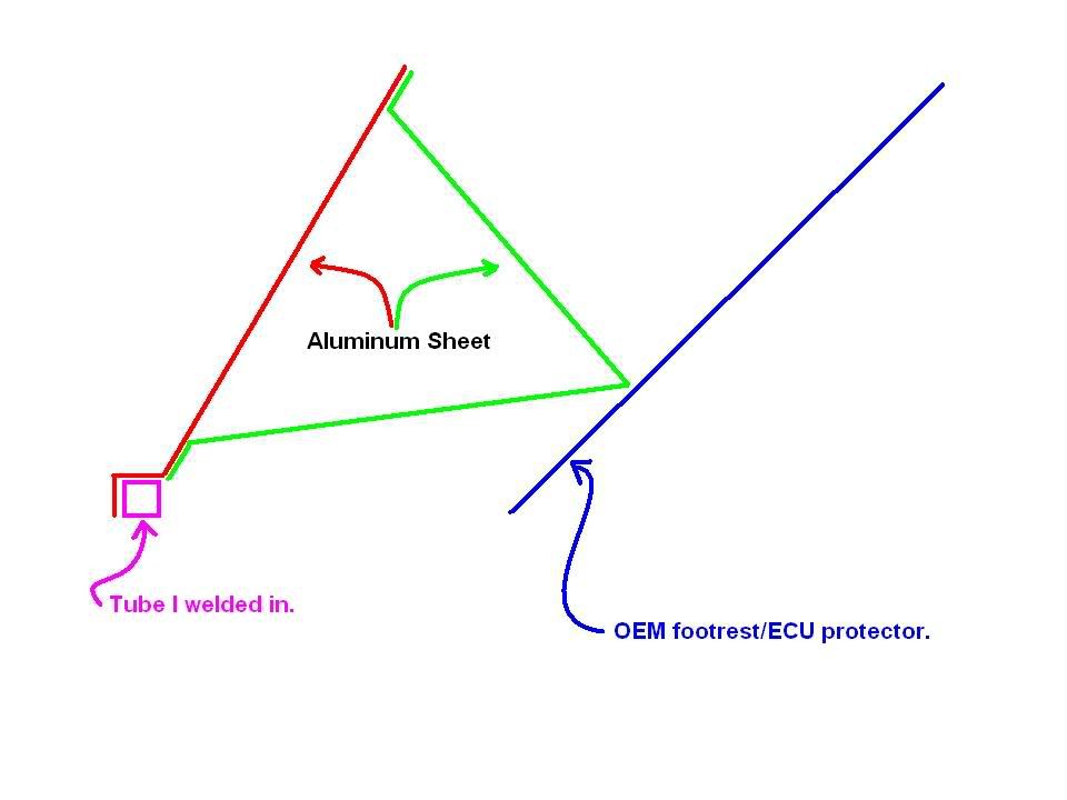

Okay, here's what I'm thinking...
You have to bear with me and use your imagination smiling smiley
The red lines are to represent the actual footrest. The green lines are to represent another bent sheet of aluminum. I'm hoping that it will add enough support to the footrest.
What are your thoughts. If you think it would work, what thickness aluminum would you recomend? Can I bend aluminum past 90 degrees? Should I make two bends instead of just the one at the base of the "V"?

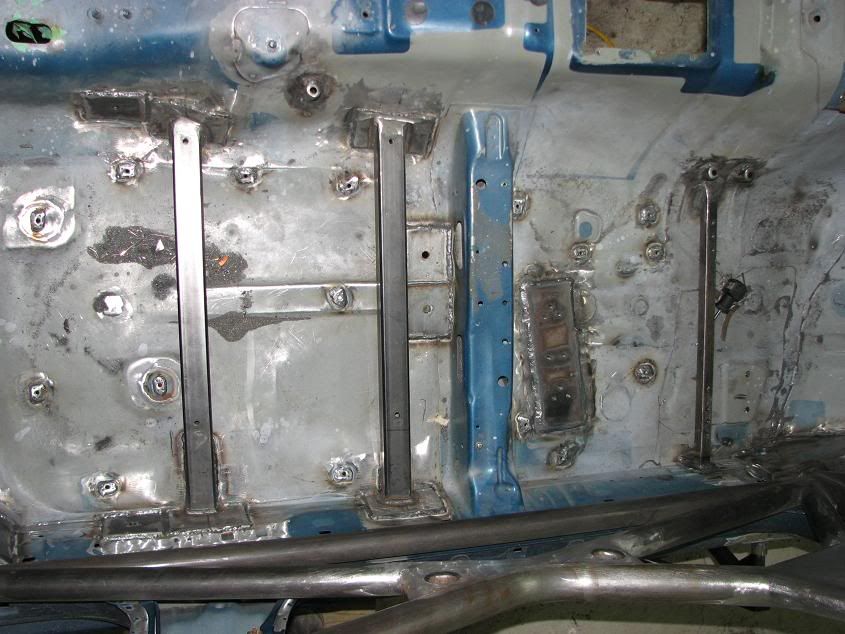

We basically used a sliding rail system. Doesn't weigh much, adjusts very quickly (about 30 seconds to loosen up the allen bolts)
Re: Co-Driver's Footrest
December 21, 2009 08:44PM
Daniel you should really have your 6'3 co-driver sit in the car. Anyone over 5'10 or so usually needs the legroom in a Subaru. With my old car and old co-driver (who is 6'3) he really didn't have the room he needed. When the car was rebuilt prior to selling it we relocated the ECU to the dash bar and tossed the stock heating system for MORE room. Last guy who co-drove it was only 5'10 or so and his legs were still in a good position read the notes from. Also I believe the sparco footrests and others are meant to collapse in a serious accident to reduce the chance of tib/fib compression fractures on impact. (I have seen this happen even in road cars so I'm not just talking out my ass). Welding and fab work look good though!
December 21, 2009 09:45PM
Oh so nice! That is a great looking cockpit. Very cool idea to use a slider. I have about six stock seats piled in the barn.
